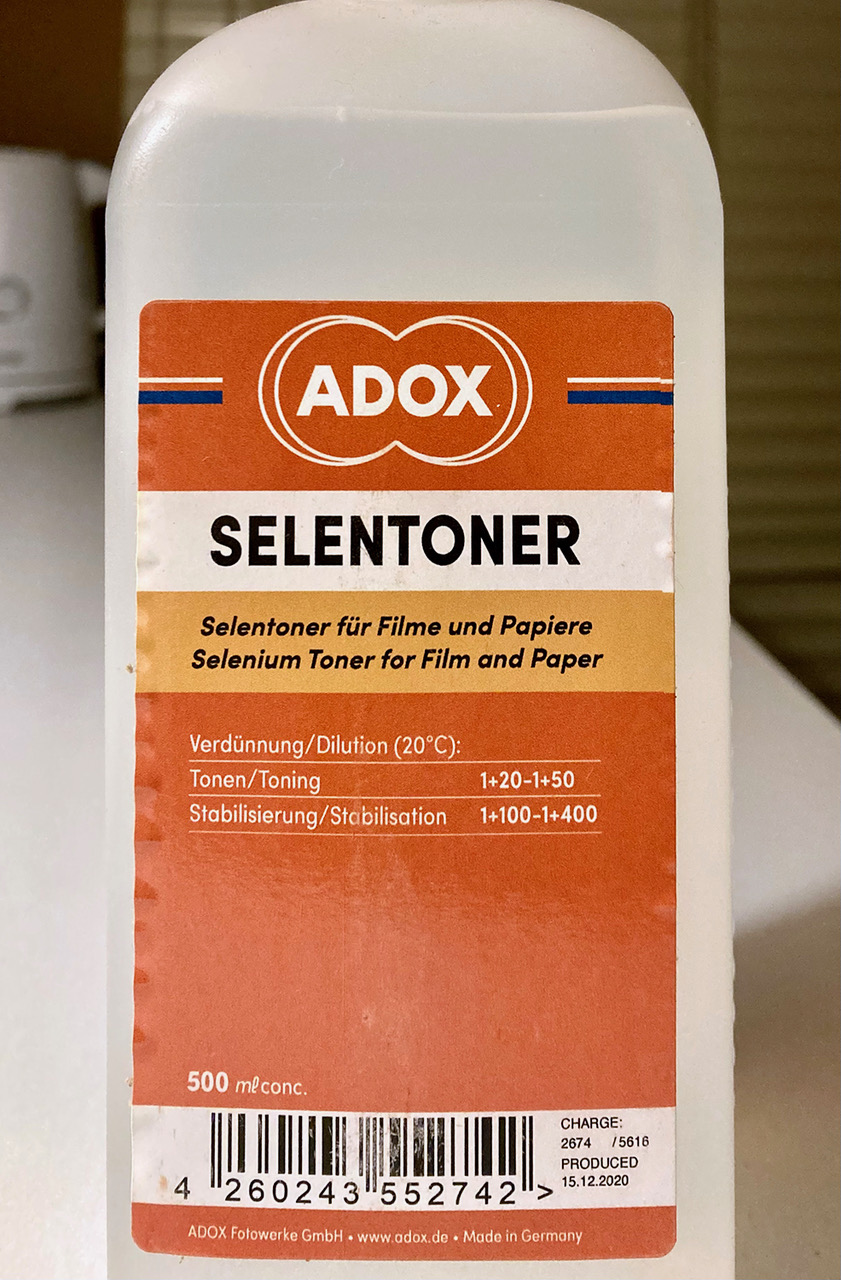

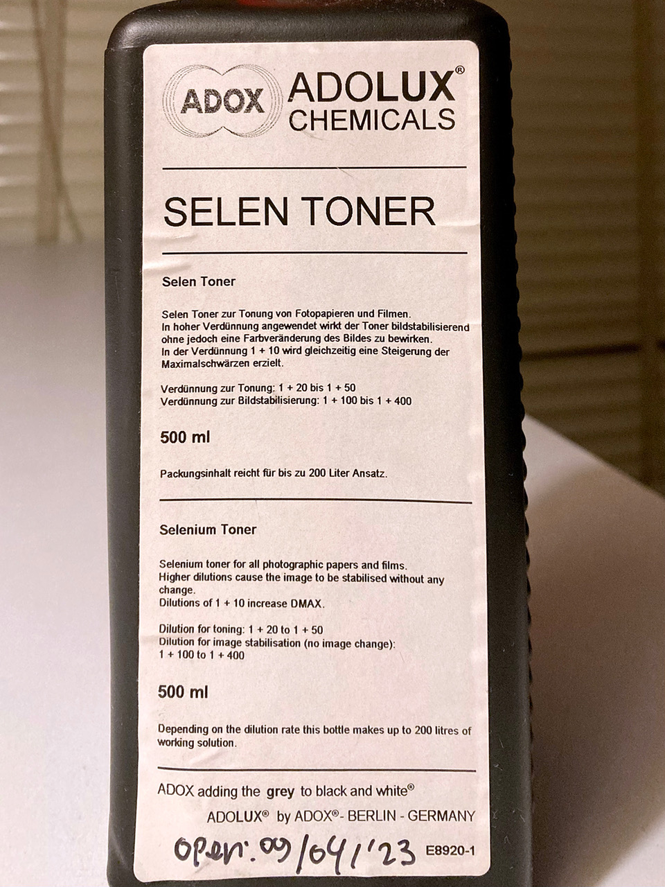

I suspect these are the same but just to be sure...
Is there a difference between the ADOLUX SELEN TONER in the black bottles and the ADOX SELENTONER in translucent bottles (see the pictures)?
On the black bottle DMAX increase (Maximalschwärzen) at 1+10 is mentioned, not on the translucent bottle.
Although the dilution for toning and image stabilisation is the same, and the toner in the black bottle does an excellent job for DMAX.
PS: I haven't tried the translucent bottle (the black is't used up yet).

I can only say that the Adolux bottle has to be over 10 years old by now. I'm only familiar with the newer version. I doubt there's much difference between them, to be honest.

I was of the same conviction, but jus wanted to be sure: different age, name, label and bottle.
Anyway the Selen Toner in that 10 years old bottle still does the thing it is supposed to do.
