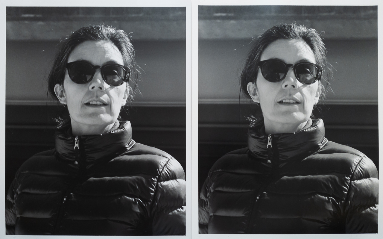

OK, folks, here are the results from a quick side-by-side comparison of Adorama VGRC Perle (sic) and Ilford MGRC Deluxe Pearl (this is the “new” paper.)
Before I get into the details, a quick note on my darkroom experience: minimal. Maybe 50 hours total?
With that out of the way, here are the details for the hardware:
Shot on Tri-X, box speed; developed in HC-110.
Enlarger is an Omega B8.
Ilford filters (the “0” and the “5”)
3-stop Neutral Density filter, because otherwise my B8 forces me down to 2 seconds frequently, even at f11.
Adorama 8x10:
12 seconds with “0” filter
5 seconds with “5” filter
Ilford 8x10:
13 seconds with “0” filter
Chemistry:
Sprint Systems Print Developer @60 seconds
Sprint Systems Stop @10 seconds
Sprint Systems Rapid Fixer @180 seconds
Water Wash @ 5 minutes
Digital ‘scanning’ of the prints:
Since I don’t currently have a macro lens for my digital system, this was shot on an iPhone using the Lightroom app, DNG format. I used a gray card, so the pictures are color/white balanced. A little (and equal) boost of contrast was given to all of the pictures, as was some noise reduction. They are otherwise not manipulated — you’ll see I added quite a bit of dust just for some street cred.
So now, the prints:
First photo is a full scale side-by side, with the Adorama on the left.

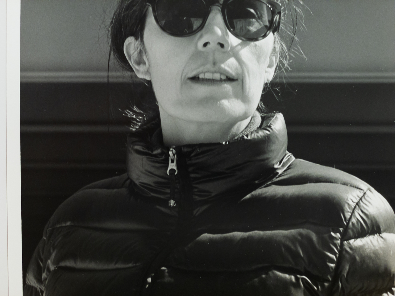

Next photo is a close-up side-by-side to show the slight difference in paper tone.

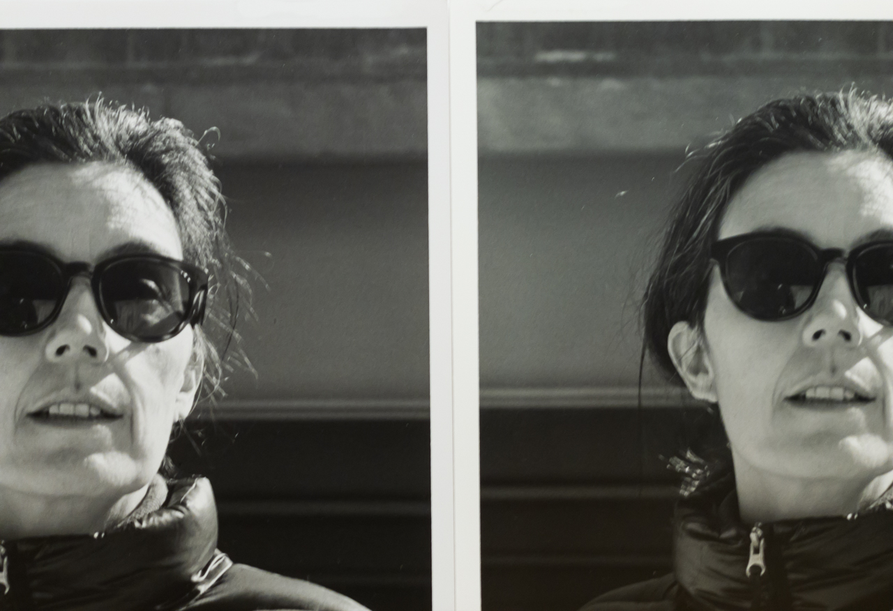

Third photo is a detail shot of Ilford.

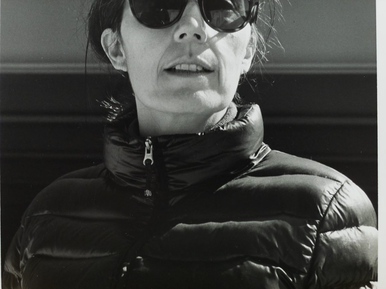

Fourth photo is similar detail shot of Adorama.
My take, FWIW:
The Ilford emulsion is finer; it captures more gradation in the middle ranges, as you can see in the detail shots. Some of the “grain” in the Adorama detail shot is attributable to my iPhone and shooting in low light, but the Adorama emulsion nonetheless displays more rough mid-range details to the naked eye regardless of my poor scan.
The Ilford emulsion and/or paper has a green cast.
The Adorama paper has an overall more contrasty or “punchy” effect than the Ilford.
The Adorama paper renders a more neutral black-and-white image.
Given the price difference, I still quite like the Adorama. I have an irrational distaste for green; I do not like green casts in my B&W. I also like the punch and the neutral tone of the Adorama paper. However, for headshots I will still consider the Ilford given the smoother rendition of skin tones.
I look forward to folks with more experience chiming in here, and poking some holes in my process.

Thanks, Dusty, looks a very close run thing to me and if it does to you then if Adorama is cheaper then you made the right choice. I can never or very seldom tell any difference in grain in two print paper that are scanned so can't express any opinion
The only way to know how close a run thing it is, would be to place these prints in front of a statistically larger enough audience and ask each of them to chose not knowing which is which. I think that it might come out 50/50 or have a large number use the "no difference so can't decide option but that's just my opinion
