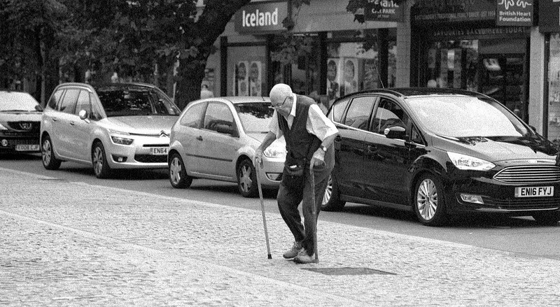

pentaxpete
Sep 23, 2010
633
Brentwood, England
I did a 12x10" print of the Old Gent crossing the road and it was quite grain-free at normal viewing distance and the Camera Club Judge didn't know it was on outdated Kodak P3200 !
:D *Big Grin*
