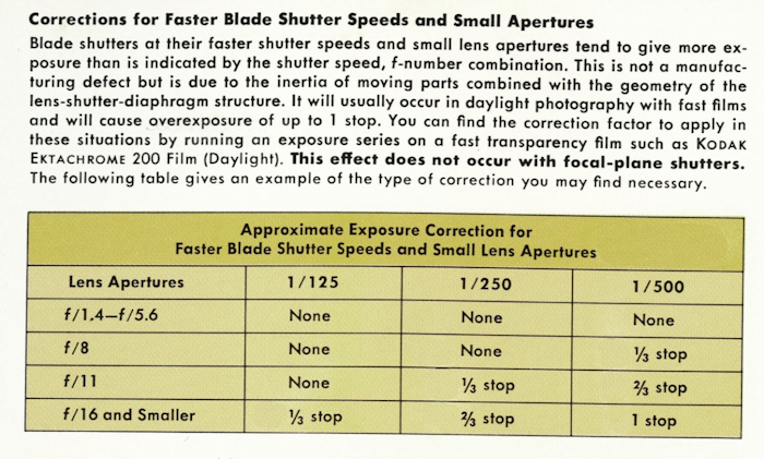

How are you checking the speeds? And at what speeds do you think they are slow? Checking the speeds of a leaf shutter is not as easy a focal plane one. Also be aware that they are usually designed to run slow by as much as 1 stop at the fast end of the scale to compensate for the low efficiency which occurs at fast speeds and wide apertures. Which is why, at fast speeds and small apertures, it's recommended to under expose.
