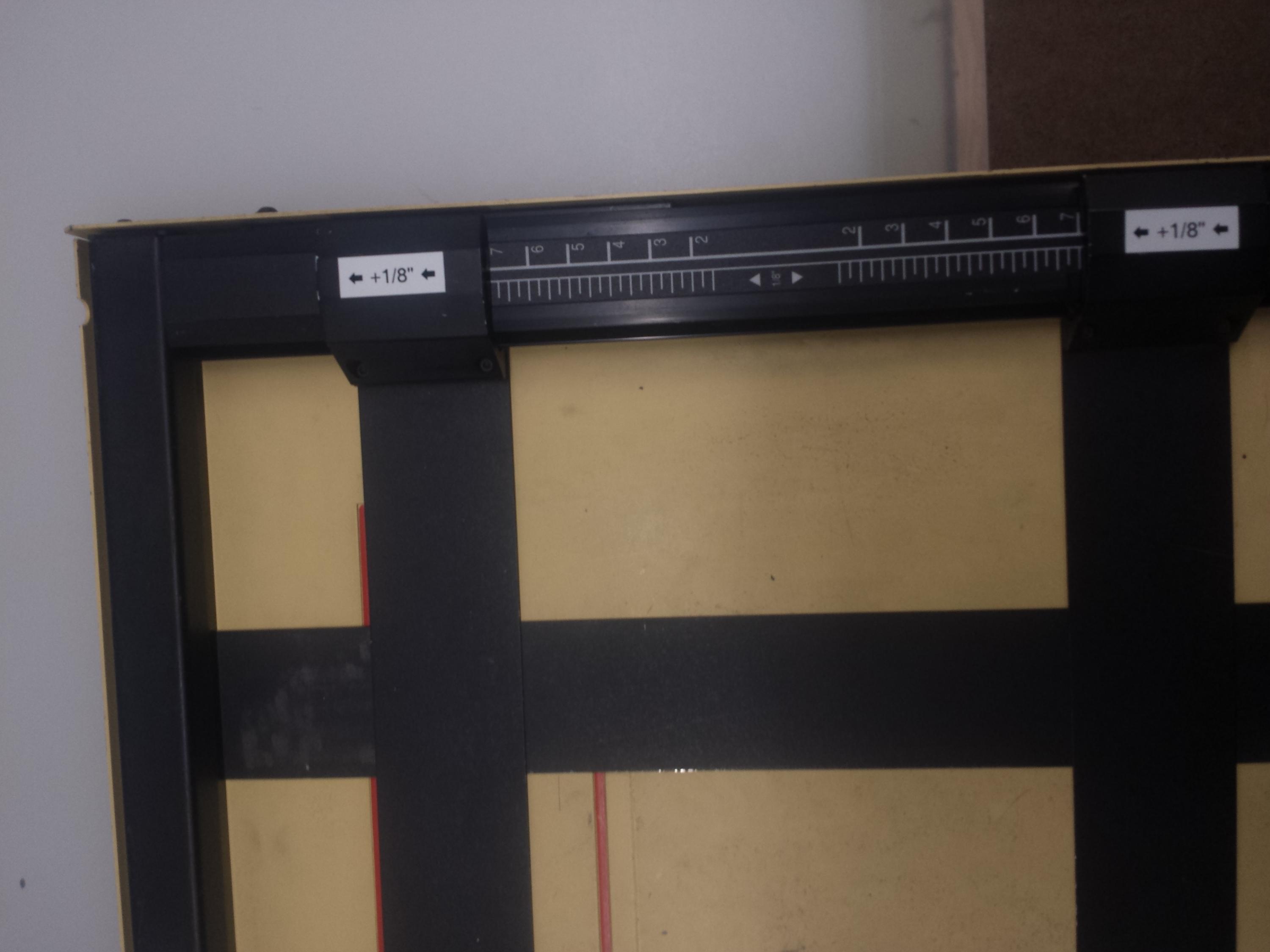

I've got a Saunders VT 1400 easel, it's a fantastic piece of equipment. I'm not the first owner, I got it used. One thing about it bothers me, and that is that the blades on the right hand sides are off by about 1/8". So If I want make a 8 x 8 print, The blades on the right hand side have to be set at 8 1/8 x 7 7/8 to get my borders consistent. Do you follow me? The other two blades on the bottom are spot on.
Everything else is perfect with the design, so to me this seems like something I can correct. Any ideas? I don't see anything obvious, but I'm a bit thick sometimes. Thanks!

This is a pretty dam nice easel, too bad the bent track .. I have a bunch of Saunders with the same problem so I will follow this thread to see if there is some better answers than what I can give you., they just go out of whack over time.
I use a measuring tape and gorrilla tape to lock the size down, I know its a bit bush league but this issue will always be there and its the only simple solution I have came up with.

Hmmm, not sure this is bent so much as out of calibration.
IIRC, there are set screws on the side(s) which allow the bars to be moved a tiny bit. This might be the problem. I have not used or calibrated one in years though.

It's definitely not bent; it's just that the ruler on the right hand side is off by approximately 1/8". The other ruler on the bottom is dead on.
PE, I'll look for the set screws and see if they give me any joy. I'll be in the darkroom tomorrow and will check.

Here are the instructions for adjusting a V-track easel.
  • 2015-09-05-0001.pdf

QUOTE=Marco Buonocore;1953785127]Hi Keith,
Thanks for the pdf. I'll try loosening the blades and lowering them by 1/8". If I can get that sorted, I'll be really happy![/QUOTE]
