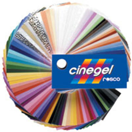

If this is a student project, rather than spending hundreds of dollars on optical glass separation filters, I'd recommend students obtain something like this (used to be able to get it for free) and place these over the lens and projector.
