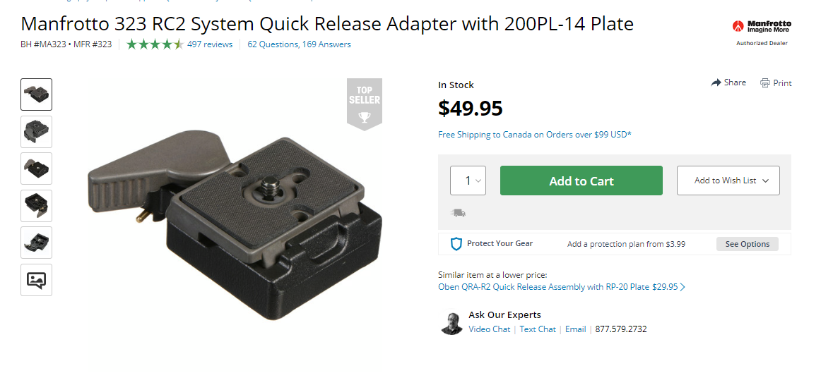

I bought a Manfrotto version for a Monopod because I had Manfrotto tripod heads designed for Manfrotto quick release plates.
Here is the B&H listing for the current version: https://www.bhphotovideo.com/c/product/554141-REG/Manfrotto_323_323_RC2_System_Quick.html

I use a Gitzo with a Manfrotto QR head, but an excellent idea of @MattKing is to just buy the adapter. After trying various QR heads I like the Manfrotto because of it's ease of use in cold weather with gloves on, and it's not the fanciest you can buy but it does exactly what you want it to.
