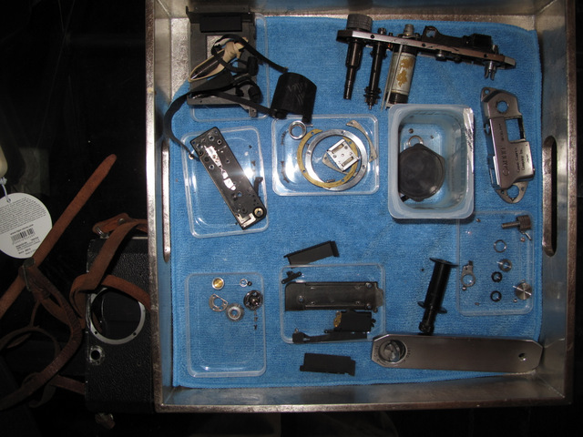

For those of you itching to suggest I send it out for a pro, too late; it is in a bajillion pieces for curtain replacement. I cannot afford to have someone do this. The camera apart. so now is the time for me to do this.

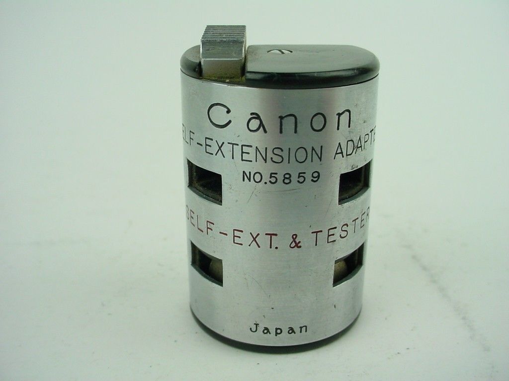

I know about the test gizmo that uses household
What do you refer to by this?

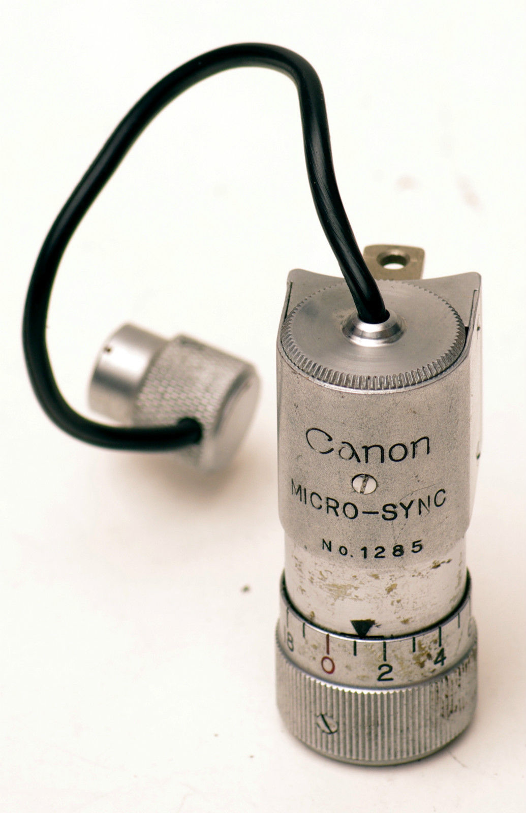

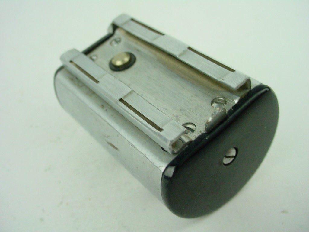

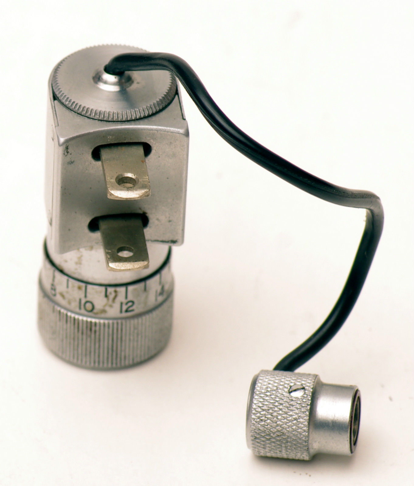

This is the Self extension adapter:
And rare as hens teeth is this:
current state of camera for those interested:
