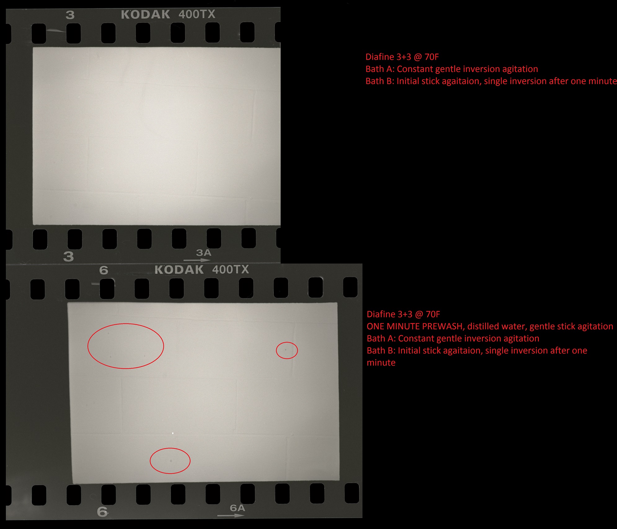

I'm still struggling with airbells in Diafine. I've done five clip tests now, and I've only produced one clip that seems free of them. Apparently that was an anomaly because a second clip doing everything the same produced them again. You can read some of the background here, but I thought I'd start a new thread since I think I know what kind of spots they are now:
attachment.php
To cut to the chase, I've tried both stick and inversion agitation (once a minute) and both three and five minute development times in each bath. I'm still getting airbells. I'm using a Paterson tank and a short clip of 35mm Tri-X (about two frames long) placed toward the core of the reel. I'm knocking the bottom and side of the tank rather briskly after each inversion cycle.
What can I try next? Should I add some PhotoFlo to the developer? If so, add it to both baths or just bath B? I mixed it with distilled water...

I've thumped, rapped, knocked, banged, etc. I'm still getting spots. For my next trick, I tried constant, gentle agitation for bath A, and a quick initial stick agitation for bath B, followed by a gentle inversion after one minute. Again, 3+3 at 70F. Still have a few small spots, but now I'm seeing some streaking. That may have been there all along; the scan was enhanced for contrast to make it more visible. These are flashed shots of a white wall. (Pardon the overlapping frames, as I had to manipulate the film in the dark to advance.)

Another clip test forthcoming. This time I repeated the previous test exactly (as best I could in terms of times, temperatures, and agitation) -- the only difference is that I started with a one minute prewash in distilled water.
The clip is drying; I'll post it later. But inspection with a loupe shows the damn things are still there. Even with a one minute prewash. Could these be something other than airbells? What else can I do?

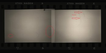

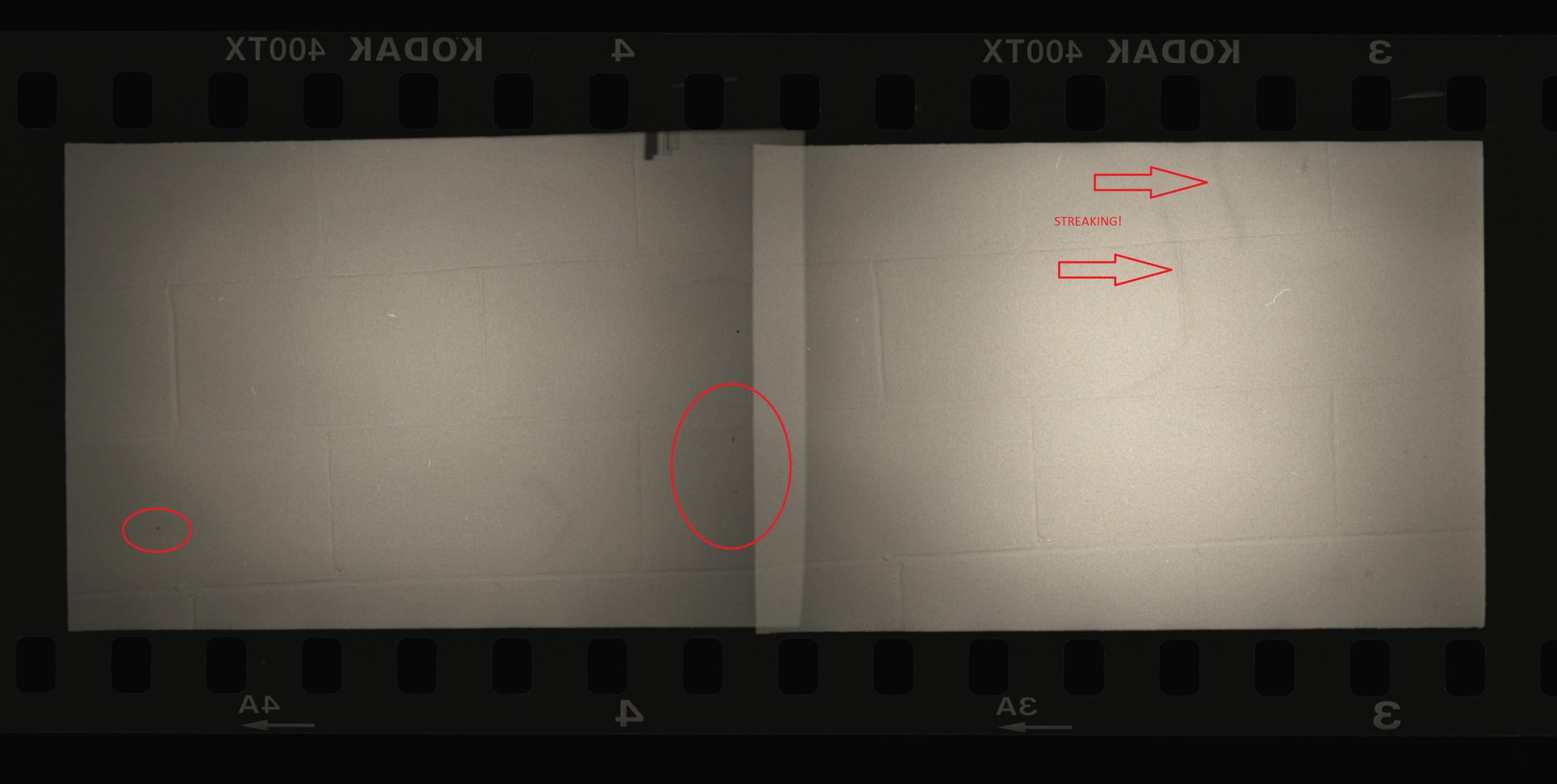

Attached is the clip -- Diafine with and without prewash, all other variables the same (within my ability). The streaking is gone, but there are actually more airbells in the prewashed clip. That could be just coincidence though (i.e. not enough evidence or testing to suggest that the prewash introduced airbells).
This perhaps will be of more interest to folks who wonder how the discouraged prewash affects development. The clips were scanned together (side by side in a single pass) with no corrections.

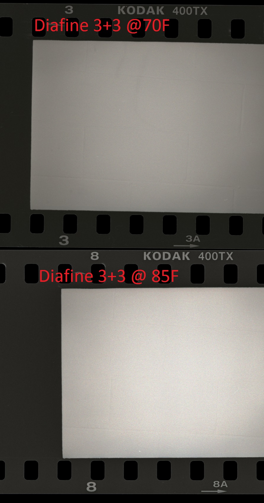

Next, I'm going to try developing at 85F and perhaps moving the clip away from the core of the reel. I may also try a run with a conventional developer. I hate to have to switch to a stainless tank and reels, but that might be a last resort.

I ran another clip at 85F, no prewash, everything else the same. This time, no spots at all and no streaks at all. What's most striking is how it has affected the density. I plan to try a second clip at high temperature and bring the agitation back to something more in line with the instructions.

Those dots look too small to be airbells on the film surely? And how are airbells supposed to cause streaks?
Are you cleaning the tank and filtering the solutions before use? If you are loading the reel in a changing-bag, give it a good shake out and vacuum-clean the inside if possible. If you are loading in a darkroom make sure the work-surface is spotless and completely dry. If you think your hands sweat at all during loading the reel, then wear nitrile gloves in case tiny drops of sweat are causing this (which would indeed be mitigated by a pre-soak as you saw).
Airbells causing streaks? I don't see how. Two different problems. I also thought they were too small to be airbells, so maybe something else is going on.

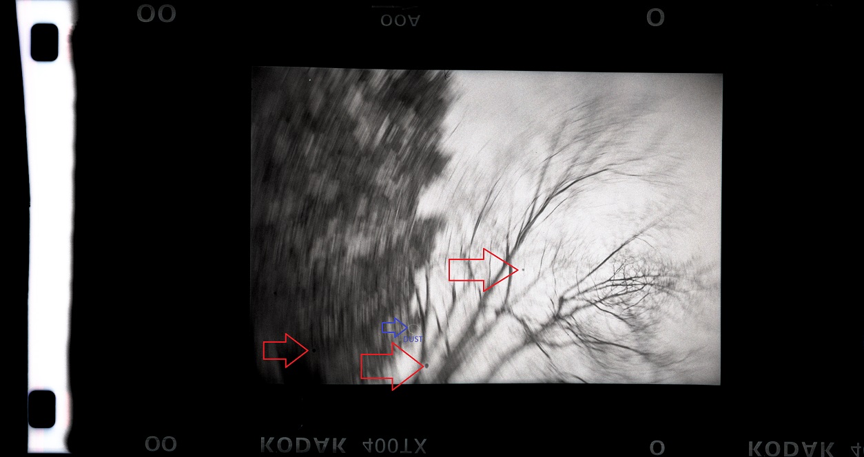

I finally put some real film through the Diafine, and the results are not disappointing. Looking at the negative, these are the inkiest blacks (highlights) I've ever gotten out of Pan F. I wish it had done more for the shadows, but that's a function of exposure and a lesson learned. Still, the contrast is good, and I'm looking forward to printing some of these.
Also, I processed these at 85F for about three-and-a-half minutes in each bath -- constant gentle inversion of bath A, near stand in bath B. With a good rap of the tank, of course. No spots that I can see with the loupe, but we'll see how the scans look.
