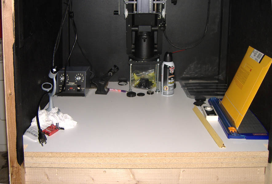

Dear tkamiya,
This is what I did. It will make a slightly cropped 20x30 on the baseboard. It is also handy when aligning the enlarger. The extensions are 3/8" threaded rod. I was going to make larger extensions but when I tried it the rods were more than stiff enough. One caveat. The bottom of the Omega column does not sit on the normal thin metal piece. When I got the enlarger it didn't come with one so I made one from 3/8" thick aluminum. This base probably contributes greatly to the rigidity.
Good luck,

I made a rolling cart where I can lower the baseboard:
This is a shot as I was setting up my darkroom....
