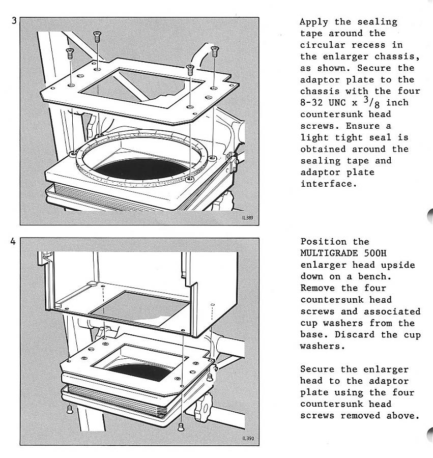

As shown in the image, the MG500 head is attached to the enlarger using an aluminium plate with holes that match up with screw holes in the enlarger below and the head above. So, if you are reasonably handy, it should be fairly simple to make.
The image is for a Beseler 4x5 enlarger, but should be fairly similar for a Durst enlarger.

Andrew, thank you for the picture. I`ve imagined it somewhat like that and I agree, it shouldn`t be too difficult to make one.

And what`s more, I just got fitting instructions for the adaptor kit from the swedish Ilford retailer who found it in his archive and it includes very good pictures of the adapter. I really didn`t think that would happen. The only thing missing is the actual measurements of the adapter plate and spacers.
So if anyone is looking for something like this I would be happy to share them with you.
