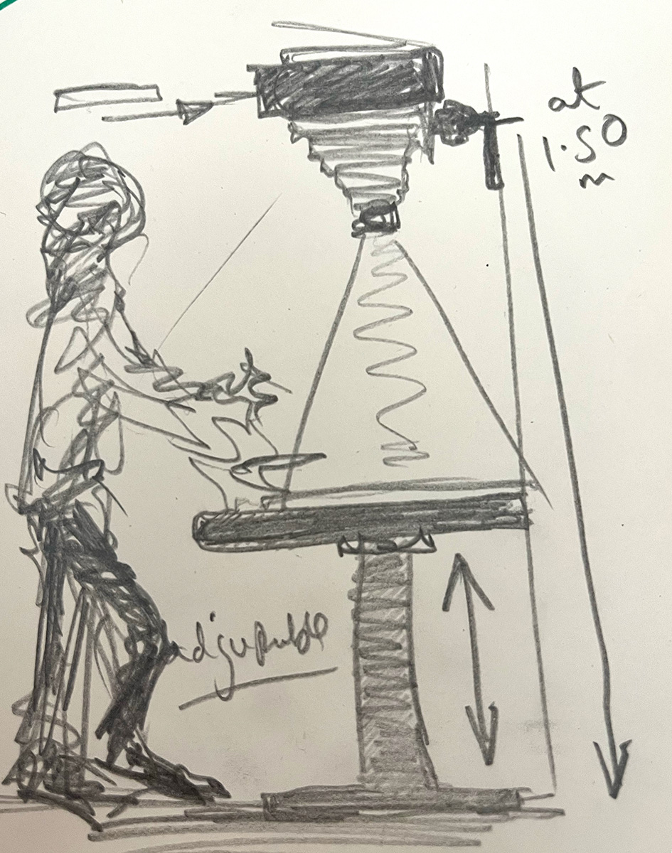

I have a Durst enlarger for 35mm and 6 x 6 which is perfect BUT it doesn't have the 'reach' to be able to print onto a 20 x 24" paper and I don't want to project onto the wall and stuff like that.
My workaround to do large prints AND work with 4 x 5 negatives is to put a wall mount with a tripod ball head to put my Chamonix camera on it to use as the 'enlarger' with the Intrepid Camera 4 x 5 enlarger kit as mentioned earlier. As my 'board' I will be using a table with adjustable height! (I am 1.78m in height so the sketch is not to scale haha)
