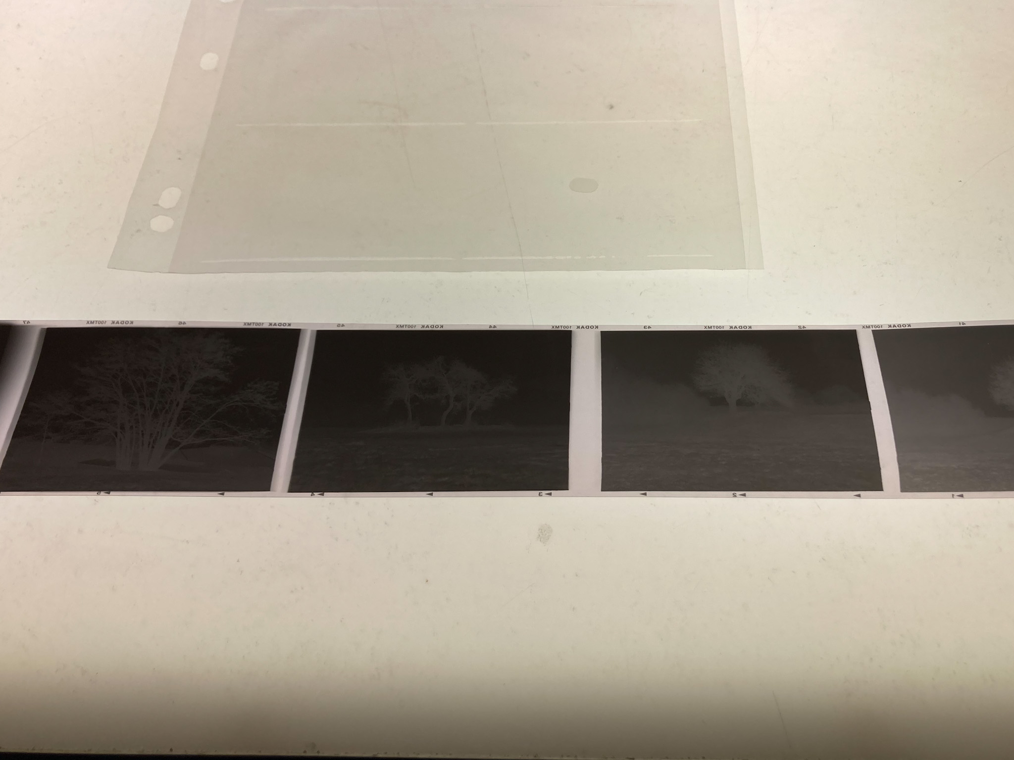

Finally got around to running a roll through for testing the back with … mixed results (ignoring my very dense negatives for a second).
First off the winding and frame spacing worked great! I was a tiny bit off on the starting position but otherwise got 9 well spaced frames.
However, every image was out of focus, and I think there might be a flange distance issue? I measure the ground glass at 0.1965 inches and the Adapt-A-Roll at 0.0990 inches. Has anyone had issues with this before?

The focus on mine seemed to be okay (haven't used it in a while, though). Does your ground glass give correct focus with standard film holders?
Hmm. I use AAR 620s with my 2x3 Graphics (> 1 AAR, > 1 Graphic), sometimes have out-of-focus shots or even rolls. So far careful checking has always found operator error. That's me, not the AAR.
OP, have you got well focused shots with other film holders?

Hmm. Did you measure the AAR's depth with film loaded? Remember that the film surface, not the back of the backing paper, should be in register with the GG.

Standard film holder depth from front surface to film is 0.197" for 2x3, 3x4, and 4x5 holders (just search "film holder depth"). It is a bit deeper for 5x7 and 8x10. It seems impossible for the Adapt-a-roll to be 0.1" - a tenth of an inch would have to be shaved off the front plate. That would also cause a much larger focus error than the one in your photo. I would check to make sure you are getting the holder seated correctly in the camera back.
