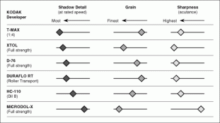

To add to the confusion, Kodak says that XTOL has got acutance AND grain, so why are we not closing down this forum and everybody uses XTOL?
