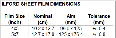

If there's any interest, I can provide sheet film dimensions for 4x5 and 5x7 that I had requested from Ilford in October 2014. A screenshot of my record in Excel is attached, showing their response. The values apply to all their sheet emulsions.

Nodda Duma
