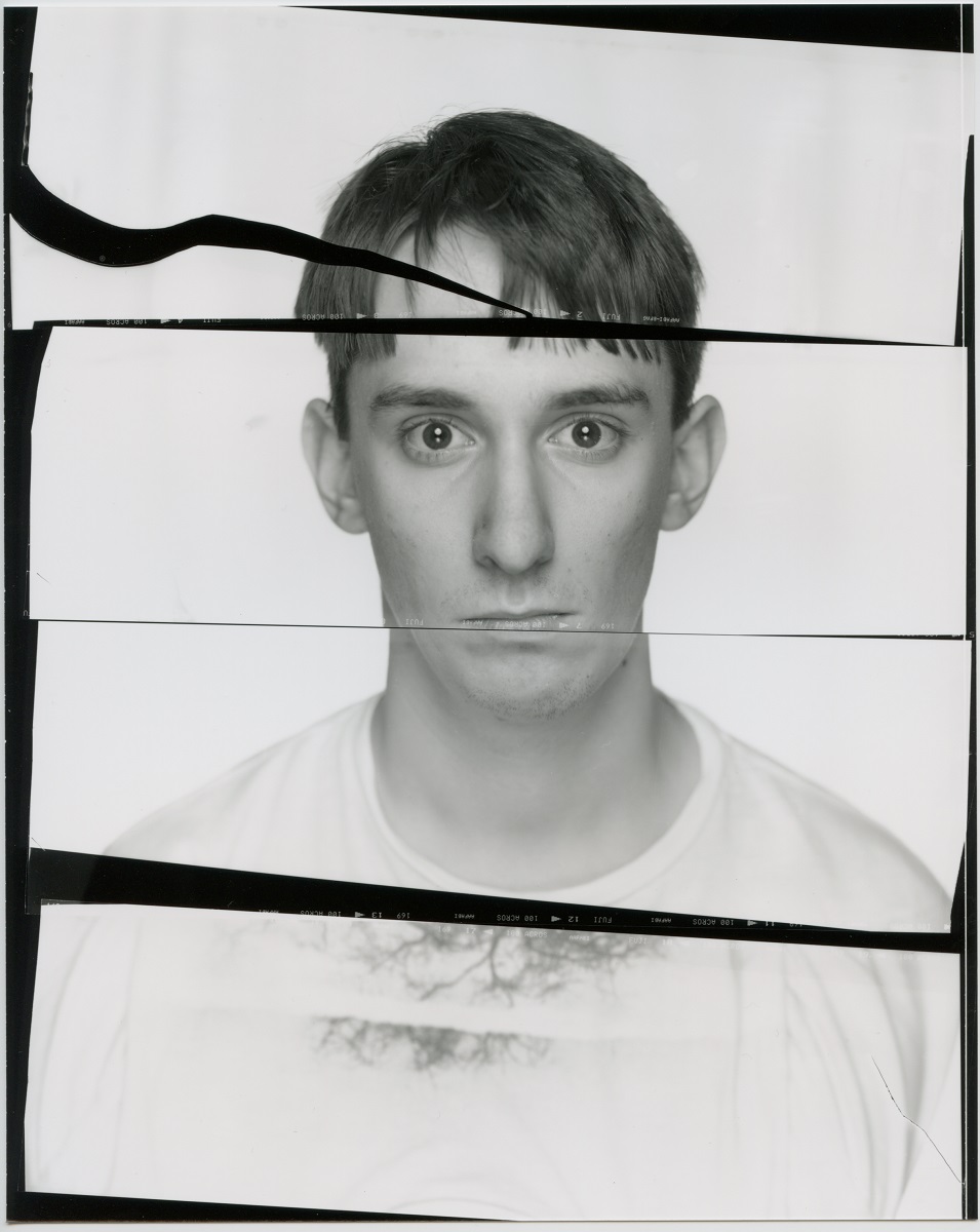

Yes. Used to create this monsterpiece. (The film tore while removing it from the holder, hence the crack in his head.)
