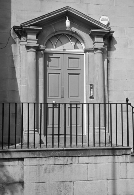

EI 100 Acros (IIIc/f 50mm f2.5 Skopar)
Pyrocat HD 1:1:100
15mins at 68F with 3min pre-soak (but not precious about temperature a couple of degrees either way on this developer)
Agitation for 1st min then three turns at 4,8,12 mins (and yes three turns at 4 after 3 mins standing from initial 1 min)
Not sure what you are hoping to achieve by further diluting and presumably standing for longer, like many others it's hard to see you can improve further on the quality of the combination, the negatives look like they were shot on 120, this is 35mm.
