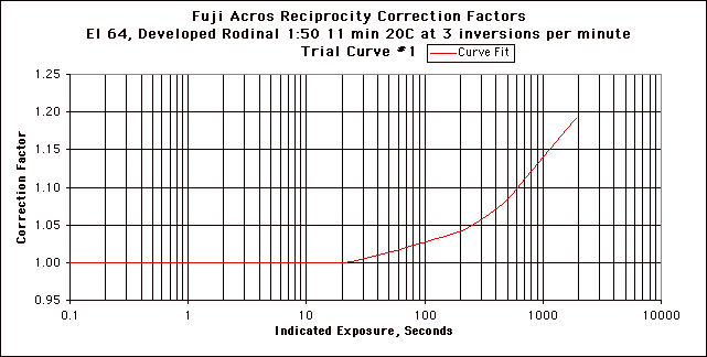

...and reciprocity!
As far as I understand there is no exposure correction up to 120 sec. and plus half stop up to 1000 sec.
But how about more than 1000 sec up to 8 hours?? For night exposures?
I cannot find anything about long exposures, please help!
Thank you!

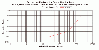

Hi Folker,
A friend passed me this table:
IT----CF---CET
80---1.02--82
160--1.04--166
240--1.05--252
480--1.08--519
960--1.14--1090
1920-1.19--2288
IT- Indicated Time
CF- Correction Factor
CET- Corrected Exposure Time
I hope this help!
Cheers
André

Thank you, Andre!
Just a little bit... ;-)

Andre's data appears to be from Kit Courter.
http://home.earthlink.net/~kitathom..._gallery/technique/reciprocity.htm#acrostable
You can see the formula for the correction factor used on Kit's page.
This works out to be a Schwarzschild factor near 0.9835 when plugged into the Covington-Schwarzschild formula where:
adjusted time in seconds = (metered time in seconds +1)^(1/Schwarzschild factor)-1
Lee
(Yes, the numbers are excessively precise, but approximately correct.)
