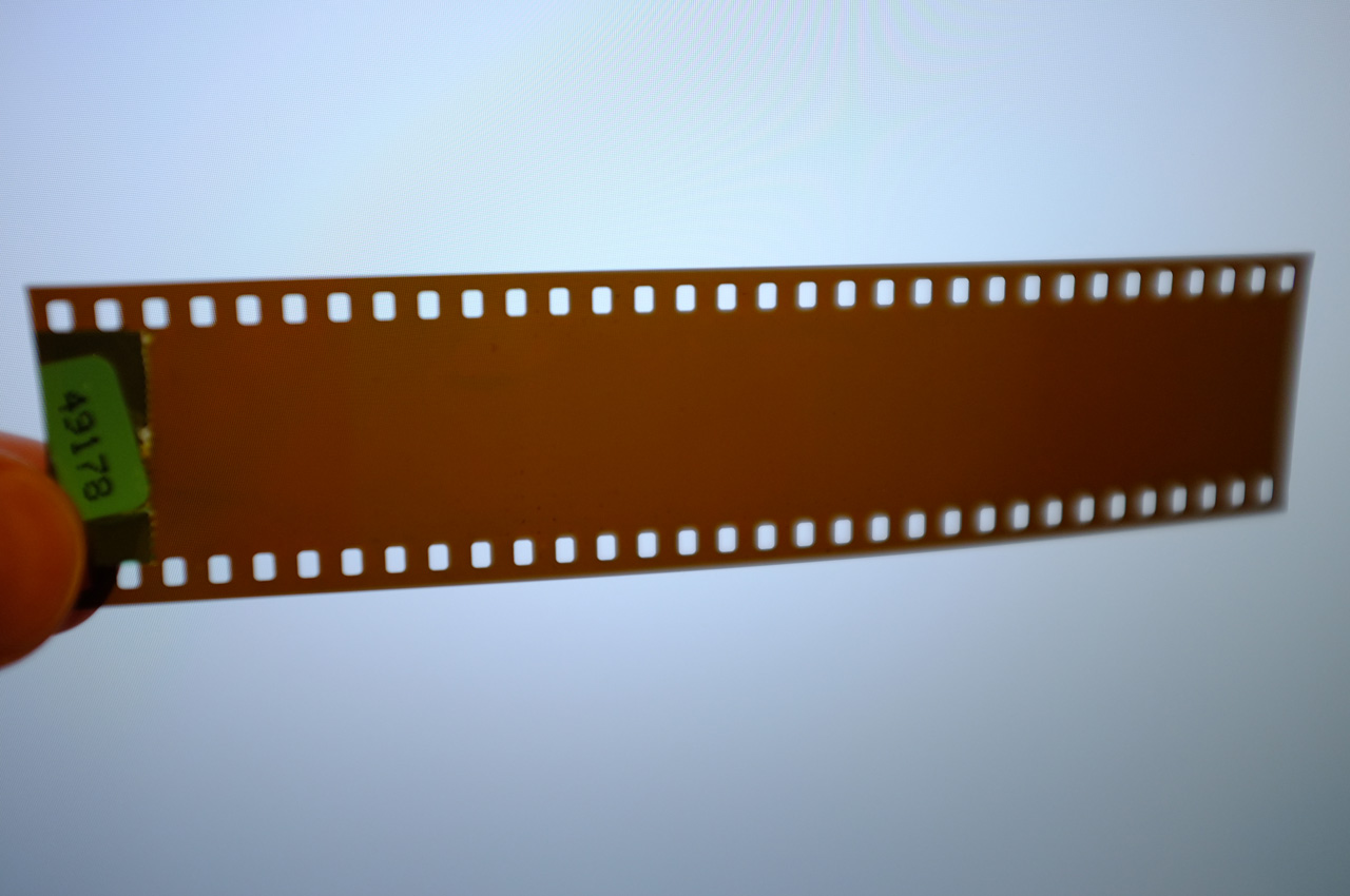

I already asked the lab if they developed in C-41 by mistake.
The entire roll came completely blank.
There's no issue with the camera and all the previous rolls (this is my first Acros) came without any problems.
Are these images sign that the lab did something wrong?
Thanks for all your help!
Something like that, all the silver has been bleach-fixed away. There are no edge markings either, so it's not blank from non-exposure.
But why is the base so orange? Is that normal for Acros? I've never used it.

Thanks for the prompt reply!
I'm new to film and this is my first Acros, the whole rolls is that color. I'll post the answer from the lab.
what frits said -- no edge numbers mean it was improperly developed -- who did you take it to? Acros is B/W film and needs to be processed in b/w chemicals, NOT color film chemicals -- my guess: Some kid who doesn't know there's a difference ran it through the c-41 machine, which may explain the orange color, or may not. I mean, b.w film comes out clear or slightly gray/purple, not orange.
almost wonder if they slipped you a blank/bad roll of old color film back.
There IS b/w film that is processed in c-41 -- kodak makes some, and ilford's xp2, and some labs even wonder "how do I process this" and I have to carefully point to the "process c-41" on the roll. The reverse mistake is also very possible.
Find a good custom lab that knows, or send your film to Blue Moon in Seattle, or even bester, learn to do your own. It is insanely easy.

I wouldn't be surprised if they did. The lab is likely trying to cover up their mistake. And for most unknowing customers that may work just fine. But they don't know you have a forum of enthusiasts and experts behind you.
I doubt Acros has an orange base, even when processed in whatever. C41 or E6 cannot tint the base or emulsion like that. A heavy orange base would make it challenging to print correctly using a conventional B&W process, including Multigrade paper.
As summicron1 said, it looks like a roll of generic Color Negative stock (print film) was handed back to you. A gray/purplish gray is more to be expected for a B&W film base.

The lab is Dale Laboratories in Hollywood, Florida.
I drooped two rolls that day; one Acros and the other a generic B&W film that came with one Electro 35 I bought. Based on their invoice the first order for the Acros Shows the CODE "BWDEV36" and for the second roll the CODE "C41DEV36". Funny thing is I called them two weeks ago to check if they can develop Acros and their response was a serious yes.
Dale Labs? I remember that outfit from ages (well, 25 years) ago.
They used to sell generic color negative film by mail order that could only be processed and printed by them, and they would supply you with a set of "slides" too. The film in question was color negative stock used in the movie industry, respooled into 35mm film canisters. Hence the slides (color positive prints). Can you hear the film director say: "print it!"
I forgot what the exact film type number was, 6036 or so.
CODE "C41DEV36" That tells you all: C41! 36 exposures. Their grand mistake.
Still, I think they caught it after the fact and pushed some print film on you, while they were trying to wash their hands clean...
Get a film processing tank, some developer and fixer and do it yourself instead. You'll be amazed how easy it is and with care far superior to anything you've seen before, aside from it being totally customizable to your process and needs.
I've seen B&W film that has gone through C-41 and it comes out as clear film, with all the emulsion having been stripped off. As others have suggested it is most likely that they threw your clear B&W film away and gave you some old colour neg film to make you think it was a camera problem. I have heard of labs doing this.

Cine-print film has no mask. It will not show the orange cast typical to most C-41 negative films.
I assume it is either
-) un-signed (why?), un-exposed still-photography (KS-perforations) C-41 film
-) masked cine-intermediary film

View attachment 58659View attachment 58660
Orange base means you got back C41 film, not Acros, seems they lost your film.
Maybe the got the film mixed up and yours is still there or someone else got it. I would press the issue with them. Good Luck.
You may be able to trace the date when the film was developed by the number on the reference tab. If it comes back before you even handed the film in then they have a lot of explaining to do and some form of compensation to cover all your troubles and effort
yup, looks like they gave you back another roll of C41. They either pooched yours or gave it to someone else. I'd start off nice, then ratchet up the heat, depending on their attitude. btw, does the claim check on the film match the check on your envelope ?
Regardless, don't let them snow you, no edge markings=no development.
The envelope came without any reference as well as the negative sleeves.

They gave you color film. Any Acros I've used (120 format) has a clear base. What happens with b/w film in color developer is that after the color development step the film is bleached, turning all the reduced silver back into a silver halide. The fixing step then removes all the halide and would leave a clear, blank film. In a color film the reaction between the exposed silver halide and the developer would form insoluble color dyes representing the image. The bleach step and then fixing removes all the silver but leaves the dye image. A b/w film has no dye couplers, so no dye image can be formed. The color developer would still form a negative image but as I mentioned above, the bleaching and fixing step would "erase' it. Color film contains (ideally) no silver once it has been fully processed.
An unexposed color film will be blank because there are no exposed halides and therefore no dyes will form. However, there would still be edge markings. A truly blank color film has just been fixed out.
They will try and tell you this was something you did wrong but it's not. It's their doing.
