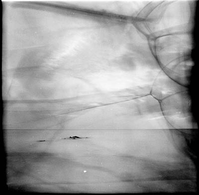

I've had that happen when the reels inside didn't turn with the tank (or at least that is what I think happened). My rotary processing of roll film in a JOBO was short lived for that reason. It made a mess out of the film.... In my case I think the bubbles were caused by Pyrocat mixed in Propylene Glycol and Edwal LFN. Edwal must have changed their formulation because I had always added it, but this was the first film I developed with a new bottle. I've since stopped using both Pyrocat/PG and LFN.
If you want to make it happen on purpose you could shake the tank then leave it on it's side for a couple minutes, then shake the tank again and leave it in a different orientation. Maybe even keep the developer to a minimum. I suppose you could add a tiny bit of Dawn too to really get the bubbles going. Might be interesting, might be crap.
