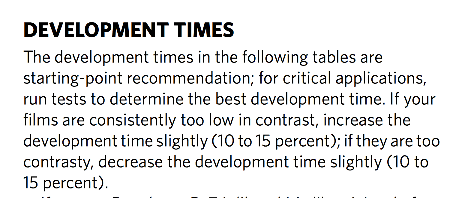

The datasheet for D-76 is available on line from Kodak Alaris. My rule of thumb is 25% but I print with multigrade paper.

By the way, development times are always recommendations. If you look at a Kodak Darkroom dataguide, there are lots of suggestions for adjusting them to take into account things like the lenses you are using, the type of enlarger you have, and other factors.
If your scans are lower in contrast than you like, it iis generally good, because post processing will adjust that. The best scans look very flat before you start working on them.
