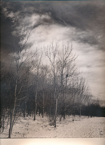

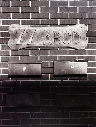

I expect that warmtone developer and toning has been used. I haven't used 300 yet but love Ilford Warmtone developed in Bromophen 1+3 then toned in Selenium 1+4 to completion. I have a bottle of Harman Warmtone developer on the shelf I've been meaning to try as well.
That image looks perhaps more like sepia rather than my selenium tones.
Old Nest 2 MGWT in Berg Selenium (Explored) by Harry Pulley, on Flickr
Brass, wood, aluminum and brick by Harry Pulley, on Flickr

Looks like a thiocarbamide (thiourea) sepia-toned print to me, probably with the pH adjusted to give yellowish rather than reddish hues. Could also have some selenium in the mix. Check out Daniel Lin's APUG gallery for some superb examples. His handle is "dlin."

Here is a link to an award winning print on the new Ilford Multigrade Art 300 paper. It says "cool base and neutral to warm image tone". Should I assume this image has been toned (as he mentions that this paper tones well)? How do you think I can get these tones myself? Dev? Strength? Toner? Is it this paper or can I get it with other papers (that I may currently own...)

Then from what I see on your website, I'd say that you should expose your negatives more and develop them less. That will help you achieve the desired tonality. The color achieved with Ilford Warmtone papers is just lovely, IMHO, especially when developed in amidol. A warm brownish black. Why not just try the paper? You can get Ansco 130 from Photographer's Formulary which is very close to amidol.
To each his own, but I can't stand any print with even the slightest hint of pink or purple. I would try printing them straight first and see if you like the color. Even Dektol yields a nice warm color with Ilford Multigrade Warmtone. Probably will with the new paper, too.

First all the image on the Internet is a fair bit darker than the real prints, not sure how that happened, I hate scanning print!
The extract below is from the Ilford site and explains how the print was made.
Hope it helps.
Regards J.
"The image was taken in 2010 on the island of Agistri in the Saronic Islands, not far from Athens, using a 4x5 view camera with a 47XL mm lens and I had been waiting for those clouds for over 4 weeks.
In the darkroom I had a change of mind on the composition and cropped the 4x5 sheet of HP5 to a small 7cm square at the enlarging stage, the base exposure at g2 (no filtration) was held back for a 1/3 of a stop at the bottom then the sky burnt in for an additional 1½ stops at g5 then developed in Bromophen 1/5 for 3 mins. After washing, the print was partially bleached and lightly sepia toned, and a final bath in selenium mixed at 1-10
I’ve printed the image on both Art 300 and WT gloss but much prefer the Art 300 even though it has a lower resolution because of the textured surface, it suits the subject I think.
This was the first image I printed with Art 300 and it is so easy to handle and a joy to use with the added bonus of being very durable throughout processing and dries flat easily. I’ve used this paper quite a bit since this first print and most people seem to love the results."
