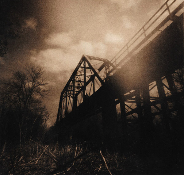

I'll probably just stick with one for now! But shooting film, I like at least trying for really optimized negs via testing, and I keep a binder full of notes and my test prints for different film and dev combos. I've done very little long exposure stuff, so reciprocity was interesting - glad I found some reliable data here vs. Ilford's chart. Really interesting to find how reciprocity affects the highs, but development can control that. I'm always glad to test this stuff and not come home with some epic shot that could have been better.
Actually, I did test the camera quickly before really dialing it in (and realized I had a bad light leak), but for lith printing, I really like how the process marries the pinhole look.
1st post-assembly test - the light leak actually lined up in a pretty cool way:

That's a great image and print. Pinhole and lith do make a good match, don't they?
