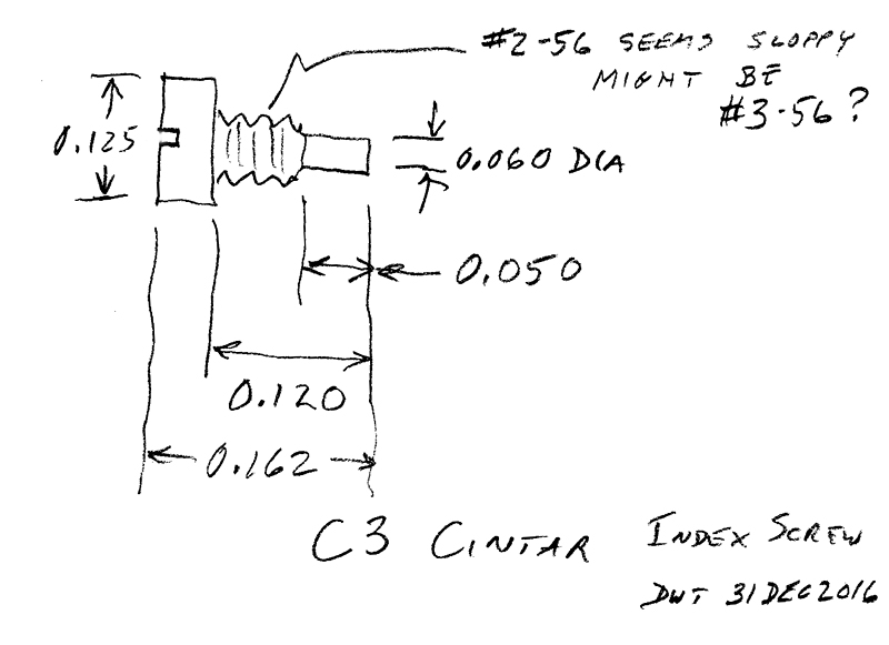

For what it's worth, I made some measurements on the one out of mine:
I used vernier calipers and should perhaps mention at this moment in time I have a left eye with the cataract fixed but the old eyeglass lens and the right eye still riddled with clouds.
If a hobby shop into model railroad stuff could yield a brass #3-56 screw (a roundhead, panhead, whatever) long enough to grip the threaded end with "something" (pin vise or hand chuck) one might be able to creatively file the tip, then cut to length.
Good luck!
(If you're like me, an hour after you've finagled out a replacement, a reflective twinkle off the floor will turn out to be the original. :errm: )

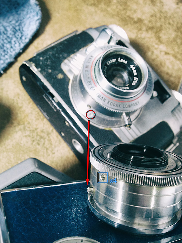

I stole a focus locking screw from a Kodak Signet (that's inoperable), sanded down the front diameter of it (pointy) so that it would glide in the groove it goes into.
Which seemed to work smoothly, short of sticking out a little (I'll probably try to find a little washer cap if I can't find the original screw).
Before I lost the index screw, I locked the focus to infinity, and then removed the indexing screw putting it down in a lens cap. Turned the lens while watching on the focus screen until it hit infinity focus from some trees in a far distance (bout quarter mile or so). Once I was satisfied that infinity was achieved I loosened the 4x screws (marked in blue), and rotated the collar around so that it would line up to the slot. Tightened down the 4x screws, and then just as I was going to put the index screw in, I dropped it, and yet to be found.
Once I got that signet screw in, I re-adjusted the rangefinder calibration, first at a measured 5 ft, adjusted against a chart, then again at infinity, and then checked again at 5ft.
Now not only is the rangefinder and lens match, the distance scale actually seems accurate (measured 5 ft, focus at 5 feet, shows 5 feet on the scale).
