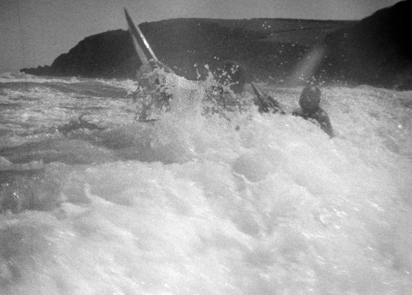

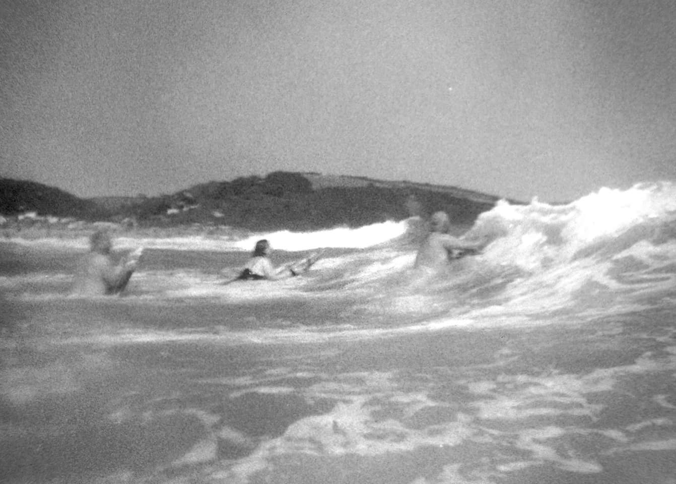

However....among my collection I have a rather basic "Vivitar Cruise Cam" underwater 35mm point and shoot. I was running some bulk loaded B&W film through it last month on holiday in Cornwall (South West coast of England) and found that the motor is so strong that it pulls the film right out of the cassette at the last exposure. I could only see this by opening the back, and since we are having a scorching summer it was blazing sunlight.
I had no dark room or changing bag to hand, so what I did was wait until night time...sit in the car with a dark duffel bag, with my hands and the camera inside, zipped up as tight as I could and a dark blanket over the top of this. I managed to re attach the film to the spindle and hand wind it back into the cassette for later processing.
The result was 3 ruined frames at the end, a further two mildly fogged but usable...and the rest were perfectly fine.
Generally the film has antihalation layers which will protect the film wound on the take-up spindle in the camera. If exposed to light for only a second, you should be OK apart from the directly exposed frames.
I have attached a couple of samples from this roll -long expired Tri-X from about 1999.
