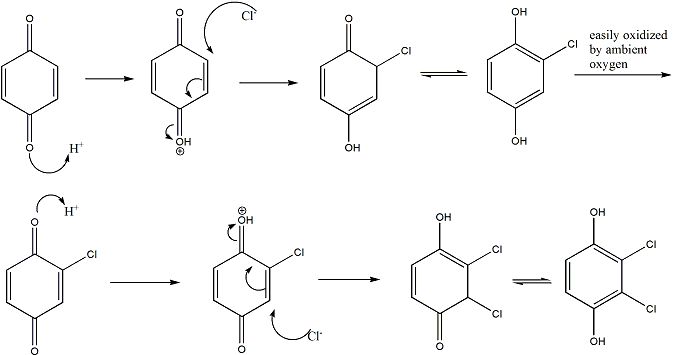

Some companies that claim to use Cl-HQ claim that they made it in-situ by adding HCl to Quinone. Well, this can only work in the absence of Oxygen. Even then it is claimed that the oxidation can be restrained by Sulfite. In the end you get either the results I've attached or you get HQMS (Hydroquinone Monosulfonate). The synthesis of Cl-HQ is actually difficult and expensive requiring the addition of Chlorine gas to Qinone in Benzene at high temperature and pressure. It is difficult to purify even then and samples that I have heard of were not pure due to decomposition.
I'm wondering if what people thought was Cl-HQ was really something else and I'm wondering what benefit they expected.
PE
