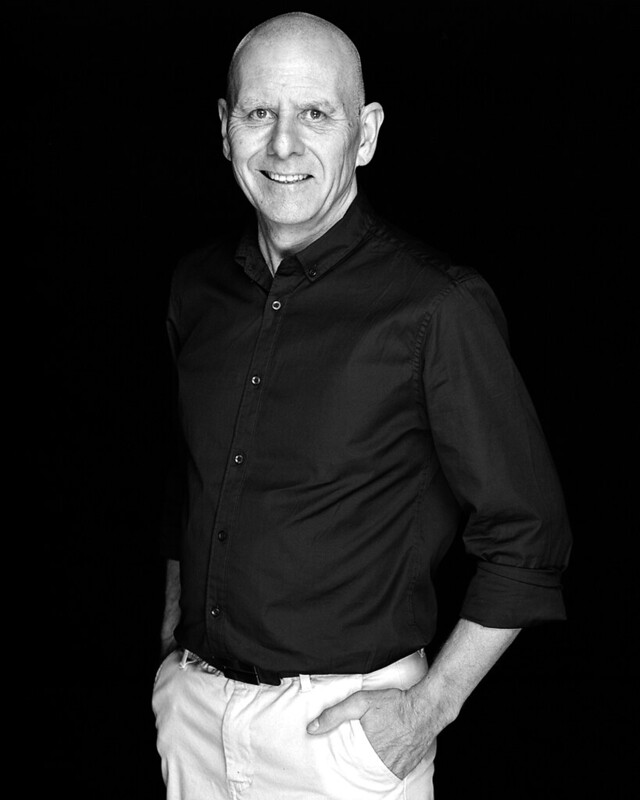

Thought I would pop in - I finally scanned the experiments I tried and here are the results (Yes, this is word for word the same post on another forum):
Dave
by Ashley Hoff, on Flickr

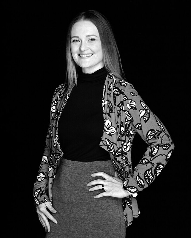

Dannielle

All shot with the same setup:
Rig: Toyo 45A, Caltar II E 210 F6.8 lens on Foma 200
Lighting: 2 Softboxes in a clamshell configuration
The effect wasn't as strong as I was expecting, but I think the lighting configuration flattened out the skin a bit.
Dave was shot with a green filter.
Dannielle was shot with a red filter.
Andrew was shot with no filter.
I think the next time I have a chance in the studio I will try a different light setup to see what I can achieve.
Cheers

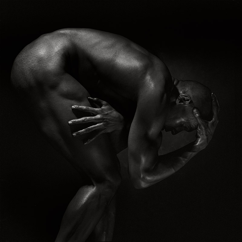

I assisted a photographer for many years, and he did a shoot with a friend who was a bodybuilder:
This guy is *not* Afro-American, he is Caucasian. The photographer simply used an 80B filter on Tri-X and shot with some mood (for this shot), others were shot similarly but on a white background.

This is quite incredible. Can you say how much "mood" contributed here in terms of the lighting to get this very tanned look? On the other site given as links there seems comments to the effect that green would act in the same way but I have never seen green produce this effect unless the model was considerably tanned in the first place. Was the print overexposed to aid the tanned rendition.
I am not trying to be "picky" but would simply like to ascertain how much the 80B's contribution was.
Thanks
pentaxuser
I'll have to check with him for you to answer these questions - I didn't work on this particular shoot, he shot it a couple of years prior to me commencing work with him.
I met him when I was at college, and remember him explaining the effect to me (pretty much what I stated above); when the shot was shown to the class, I let others comment on it, without them being told how it was shot, only commenting when pressed by the lecturer.
Could be a couple of weeks - he's currently shooting in China.

Ok. I was able to chat to the photographer last night, as he was chilling out after the day's shoot. He can't recall every tiny detail (they were shot over 20 years ago), but he was able to recall the following:
  • Images shot on the black background were shot on Tri-X
  • Images shot on the white background were shot on 400 TMax
  • Underexposed by about 2/3 of a stop
  • He only used gridded lights on the model
  • Shot them on his Blad
  • Full-frame
  • The printer undertook a lot of dodging and burning in - these are analog prints, made before the dawn of the digital age
  • All images were printed on Ilford paper (but he can't recall the actual name of the paper)
  • He thinks the owner of Atkins Technicolor still has one of the series hanging in his office
In his own words: "I was after the contrast!"
I did meet the model around 2006/7 at the photographer's place; I guess we usually describe his skin-tone as "olive" (?), ie: not whiter-than-white, like Northern Europeans, but he's not overly tanned either.
