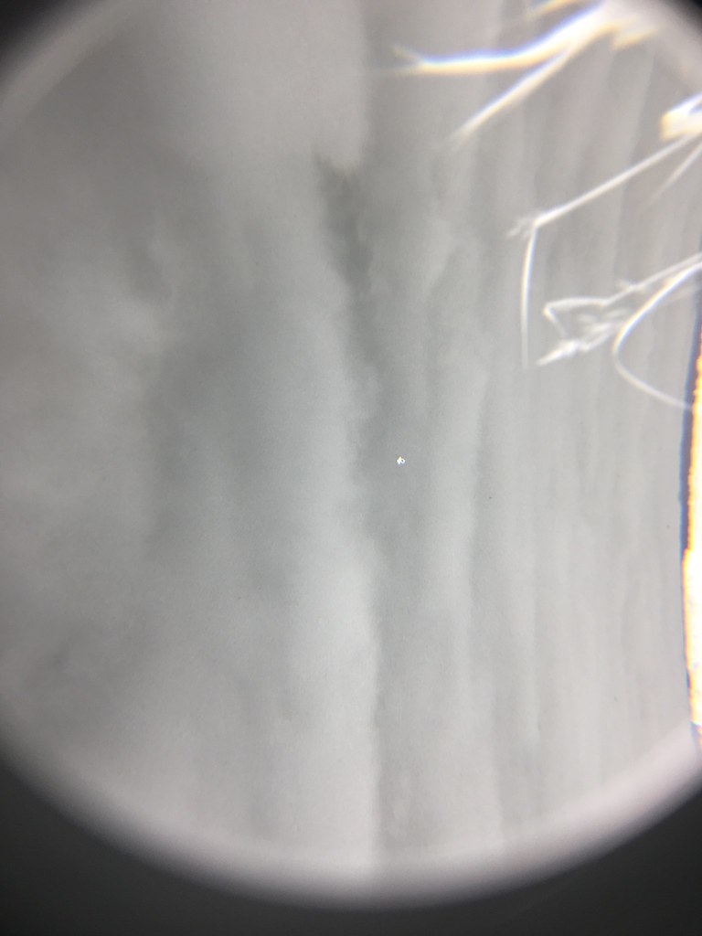

The scratches are very thin and in a group of about 4 or 5 that run the continuous length of the film, and are repeatable. They can't be seen on a light table, but are obvious in low density areas when looking at the negatives in normal light reflective light. Before I go looking for something on the rollers, is there anything obvious I should be looking for? Is there a best option for cleaning rollers?
I also occasionally am getting tiny dust spots... is it possible this is foam coming out of the light trap? Or do I just need to canned air the whole magazine? See photo of an example offending "UFO"
Y'all are the best.

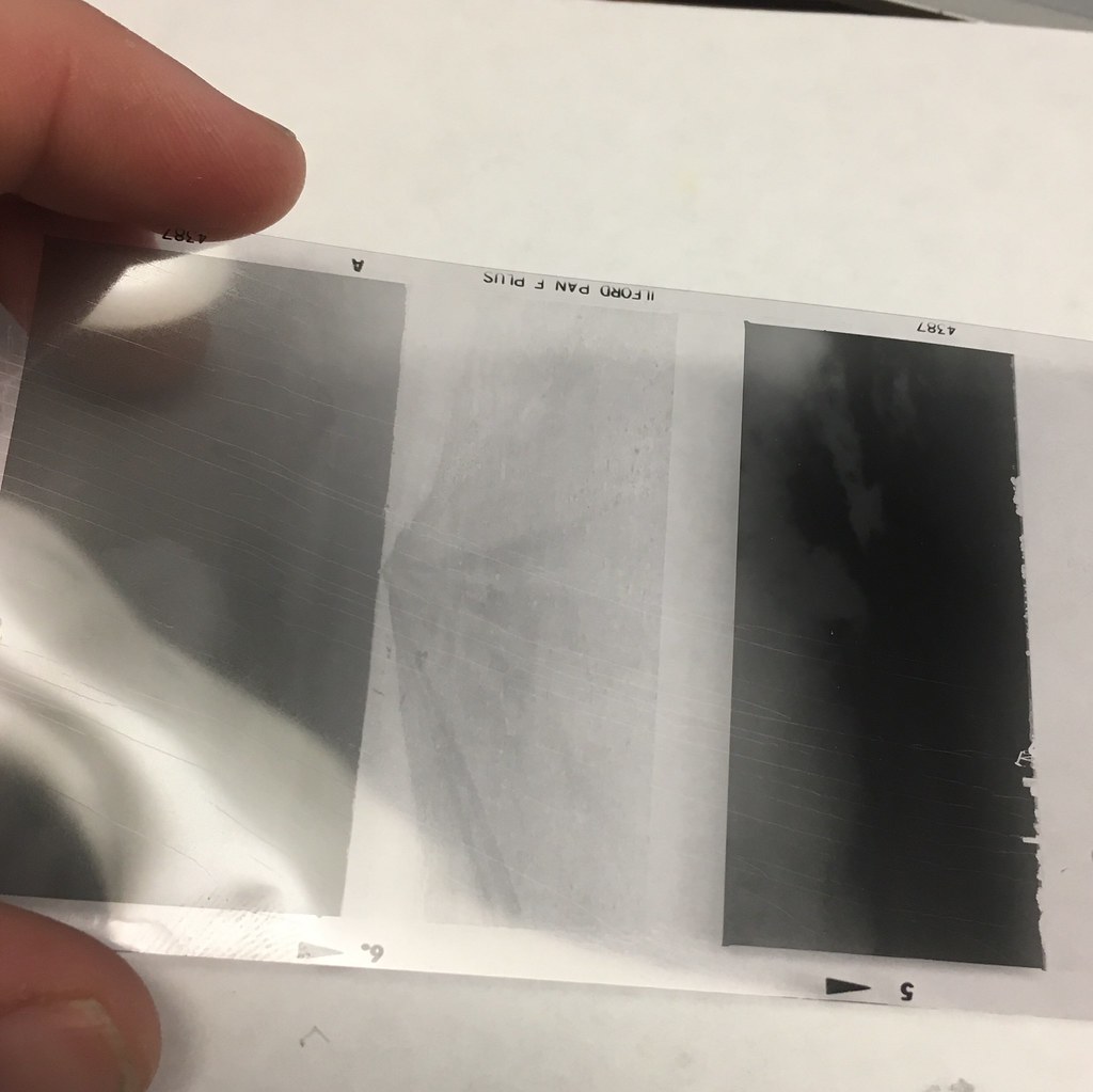

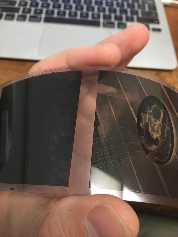

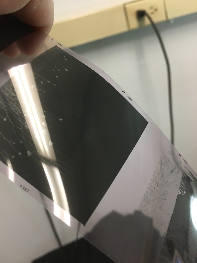

Here are some pics of the marks where they are reflected. They are tough to photograph. Maybe post in the B&W film/chem forum?

The diagonal marks at the lower left of that frame did not occur in the camera.
The film moves linearly on the long axis, not diagonally.
They happened after the film was removed from the magazine.

Interesting. It's a wavy pattern that runs the entire length of the film strip.
MattKing
Apr 24, 2005
55,337
Delta, BC Canada
Those look like drying marks to me.

A few notes: I use laboratory grade RO/DI water for all processing steps, start to finish. I also use photo-flo in this water for final soak before drying, a few drops per half liter.
Here's a kicker: I just looked at rolls developed using ID-11 + Ilford Rapid Fixer and these marks are absent.
The rolls that exhibit them were ALL developed in FX-39 and fixed with TF-4, and actually come from BOTH of my Hasselblad backs, an A12 and C12. Perhaps I should post this to the B+W forum? I don't have any processed using this combo that are free of the marks.
Two films have been affected: Ilford Delta 100 Pro and Ilford Pan F plus 50.

Static electricity produces very distinctive marks. They appear as either stars or dendrites when the humidity is low. Since the film is essentially exposed they appear black in the negative.

I have never seen these types of marks with any of my backs. Those are a ton of lines and I'd be hard pressed tothink of what could happen to a back to cause those. also looks like the lines are diagonal to the film direction which should rule out the back. imo, I'd be looking at processing
