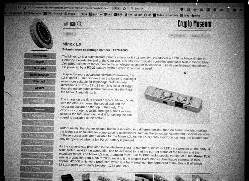

i've stumbled across a Minox B and an LX. The B is as expected - speeds are good, meter is a lost cause, like most old selenium cell meters.
But the LX is perplexing. Manually set speeds are accurate. Automatic speeds are off by 2 2/3 stops (too slow), quite consistently. Power is from a precision bench supply at 5.6v, but voltage variations don't seem to matter, which is nice to see. Results are the same with the battery I'm using in my 35GT (which is very accurate.)
The 2 2/3 stop discrepancy is suspiciously close to the value of the ND filter, but it's not in place.
Am I just confused or something?
What makes you think the auto exposure is off? Have you tested the LX with film? Is there some dirt on the small meter window? I have 3 of these (Minox LX) and have always found that the auto shutter either works or fails completely. I have had them serviced by Don Goldberg (aka DAG camera) who has replaced a couple of shutter assemblies for me.

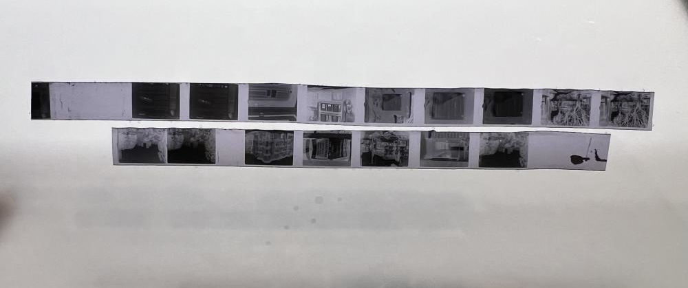

The film is extremely overexposed. Setting the ASA to just under 400 when using 50 speed film gives good exposures.
You can hear the electric shutter's opening and closing clicks, and measuring them with an oscilloscope confirms the timing.
