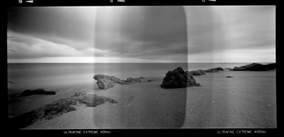

I think "new experiences" must be going around Eric. I just developed some film and it seems one reel wasn't rotating with the tank so most of the roll had these stripes on it. Always something! Lol. First time it ever happened. At least it only affected one roll. I hope your film came out better than this-
What a shame, that would have made a gorgeous photo.

I've posted a scan of one of the images from the offending roll. Besides the negs being a bit "crunchy" for the over development only a few were totally ruined.
