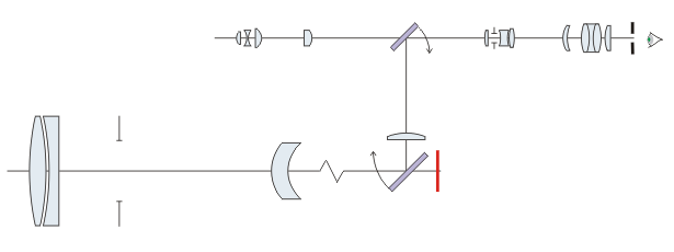

... at least I do not remember.
In the late 70 at KMZ one
-) took off the prism of a 35mm SLR, but kept the groundglass and field-lens
-) as substitute a lens of 40° angular view, a additional mirror and an eyepiece were set on top.
The idea was to gain with a lens of long FL (300mm) a finder that yields an overview.
Something lacking at SLRs and often discussed in comparison with non-reflex cameras. Only here it is brought to an extreme.
Once an interesting detail was found and centered, the upper mirror was flipped to 45° and the groundglass image appeared to be focused on.
In the prototype taking-lens, overview-lens and body formed a unit:
It never made it into production.

Hmm. Target acquisition is always a problem with long lenses, especially with the first long lens one gets. I remember wondering how I could ever find the subject with my 200/4 Nikkor the first time I looked through it. And I remember wondering how I could ever find the subject with my 700/8 Questar the first time I looked through it. Practice solved the problems.
In other words, interesting device but very much a solution in search of a problem. Thanks for showing it to us.

Maybe that is why it never made it into production. But I know some produced photo stuff, where I wonder much more.
A cheap and simple alternative would be mounting a sportsfinder on the hot-shoe. There even was such accessory finder made, but I never came it across. But such sportsfinder as assistance would work best when the lens is mounted on a tripod.
This KMZ idea though would allow to keep the lens handheld as one keeps the eye at the finder, but just flips that mirror. It is not clear though how it is flipped. Ideal would be the first stage of a double-stage electrical release.

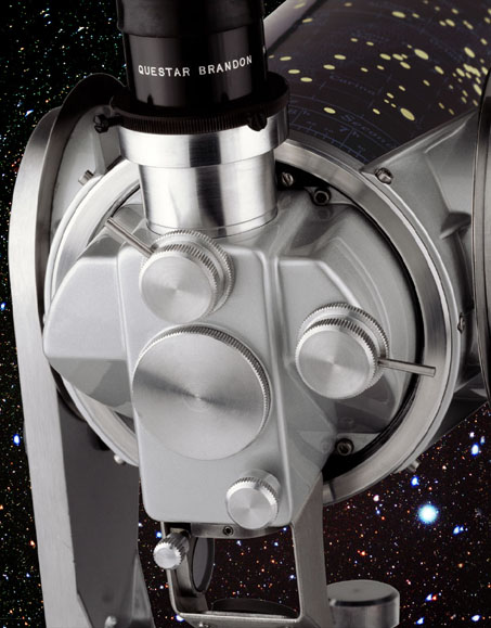

I'm not sure how they did it, but the 3-1/2" Questar had a clever system that didn't require a separate finder. There was just the eyepiece behind the main mirror and when you looked through it, you saw a wide field. Flipping a lever gave you the telescopic view.

Theo, the Q700 isn't a telescope. It is a mirror lens in T-mount to be used on 35 mm SLRs.

I did not know that. Looked it up:
It employs the same basic prinziplev as the KMZ design:
Via a flippable mirror one can choose between looking through the main lens or through a finder with a path alongside, underneath the lens barrel. There are changable enlargements at the eypiece too.

I would bet that you cannot get a focal length like that with a TLR.
You might not have realized but the body intended for this KMZ design and used for the prototype was a plain SLR, a Zenit in this case.
Basically one could have used any long FL lens, even with extender.
In the prototype though taking lens and accessory lens are seemingly mechanically fixed to each other, but that need not neccessarily be so. Though it yields the most sturdiest result. Beside that KMZ favourized kit designs in general for fast tele-photography.
