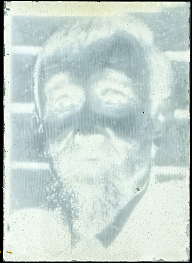

Because I ran out out of some chemicals that I use in my typical research, I started fooling around with what I had. I cecided to try one of my "cmyk color separations" on multipal layers of glass, but use only white pigment on each layer. Since I had no white watercolor pigment, I used White Out. The stuff used to correct typewriting errors. (Who still uses typewriters?!) The MSDS lists only TiO2 and 2 kinds of naphtha as the components. I added the White Out to the "Glass Subbing" that I have described on this Forum. It is ,basicly, PVA treated with amino- silane. Tot this I added a saturated solution of potasium dichromate. Coated onto clean glass, dried,exposed and developed in warm water.
I have attached two images. They are both of the same 4 layered glass image. One is scaned as a transparency and is a positive image. The other is scaned as a reflective image and looks like the negatice of the other.

Unfotunately no. Transmited light is required for it to look like a positive. See attachement.

Gary- There being 1/16 inch of glass between each layer, there is already alot of relief. It does not show with scans. As you can see from the scans, there is already "blacks" in the transmited light scan. I think that this is due to the fact that the transmited light is partialy blocked by the highlights in the glass negative.

Gary- since there is 1/16 inch of glass between each layer, there is already alot of relief. Looking at the transmited light image, you can see that there are already" blacks". It is due to the fact that the white pigment partialy blocks the transmited light.
