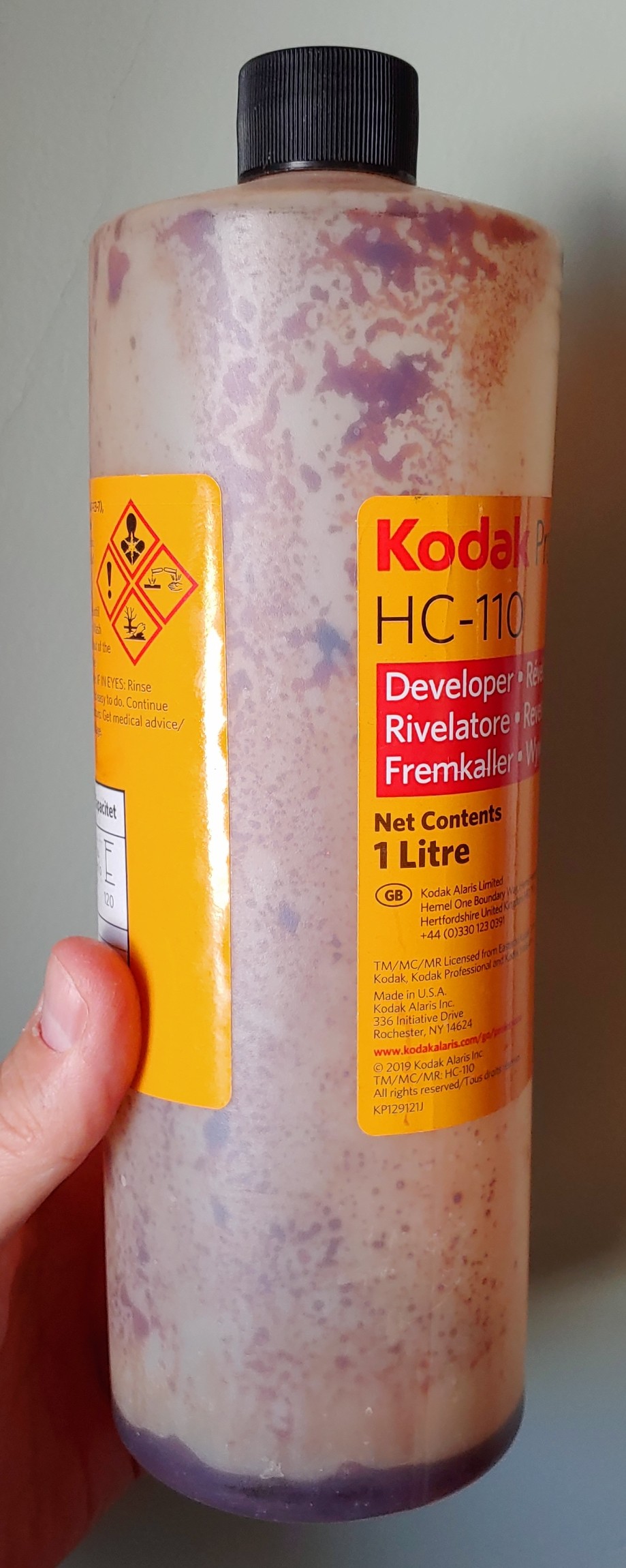

I purchased a fresh bottle of HC-110 right before Covid hit in 2020. For obvious reasons, life got in the way and I didn't get around to cracking it open until this past Tuesday, 11/16/2021. The manufacturer's expiration date stamped on it is 11/21.
Given the new formulation's unknown longevity, I immediately decanted it into glass bottles leaving no air-space other than in my "working" bottle that I'm keeping purged with butane.
The next morning, about 12 hours later, the remnants left in the bottle looked like the attached picture. It's worth noting that I doubt moisture is at play; my house has been at 15% relative humidity this winter. Also, there were some crystals precipitated out before I opened it. It would seem "new" HC-110 is considerably more sensitive to O2 than the old, thick formula.
Or perhaps its more sensitive to butane.....

I introduced butane into the glass bottle I'm using as an oxygen purge, not the empty plastic bottle. For anyone who's curious, look at the MSDS for Tetanal "Protectan Spray" linked below. It's butane, propane and isobutane - portable cook stove gas.
As for testing what's left in the bottle, it's a mix of liquid and precipitated crystals. There might be enough left to make some sort of working solution out of. I'll run a test strip off of the decanted HC-110 tonight and note the time; I plan to develop a roll @ dilution H, I'll see if I can work up a comparison to the brown sludge.
Either way, the old formulation didn't darken nearly this fast.

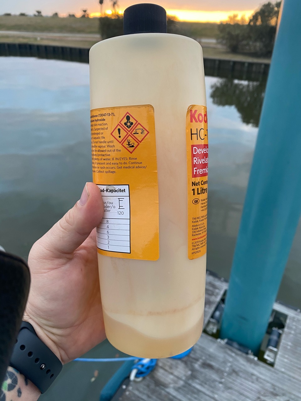

This is my bottle, which has been this way since 2/9 as previously stated. Bottle expires 01/22. It’s clearly darkened some, but not to the extent of the OP. Maybe the colder temps kept it longer?

There is way more air in that almost emptied bottle that the OP pictured.
Not just more air, but the surface area exposed to the air is far, far greater. ChristopherCoy's bottle has a single layer of liquid exposed to air. Phreon's bottle, nearly everything on the sides of the bottle is heavily exposed to air.

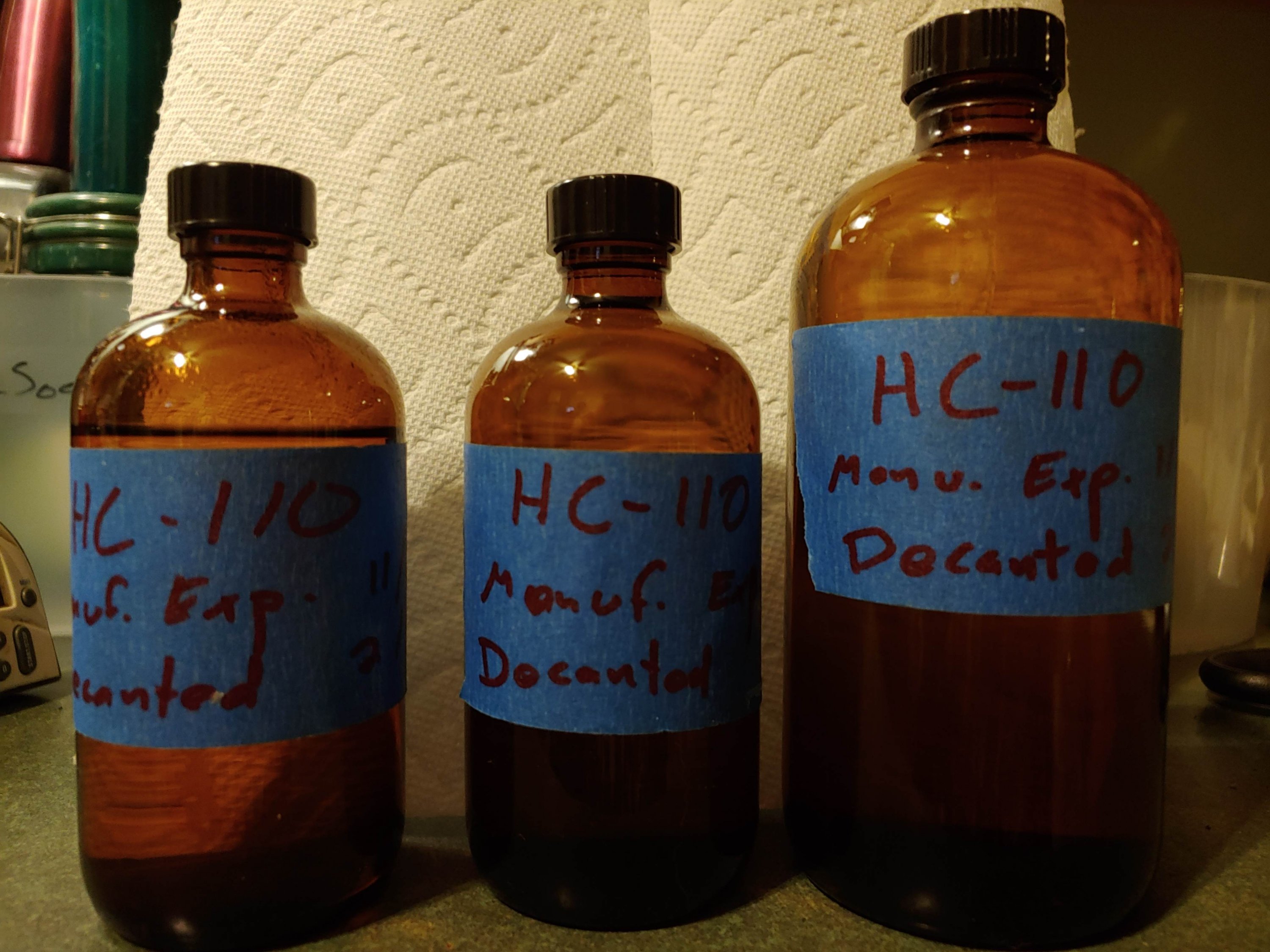

Pictured/attached is how I'm storing 1L of HC-110, two 8 oz and one 16 oz bottle. There was a little spillage making sure 2 of those bottles were filled to the brim when being capped. The two on the right are full, the leftmost has "air" space.
That bottle has more than what's left in my bottle by 2 or 3 times.

Something to consider as if you're putting the HC-110 into bottles is the seal of the cap. For some bottles I have, I was able to find rubber washers that fit.

Perhaps others who buy the new HC110 will decant the whole bottle into smaller bottles and if they do it will be helpful if they were to keep the empty HC110 bottle and report (a) how soon the straw coloured HC110 turns the same colour as the OP's bottle and (b) try if possible to see if there is enough of the cherry stuff left to make a small quantity of diluted HC110 and use if for a leader test

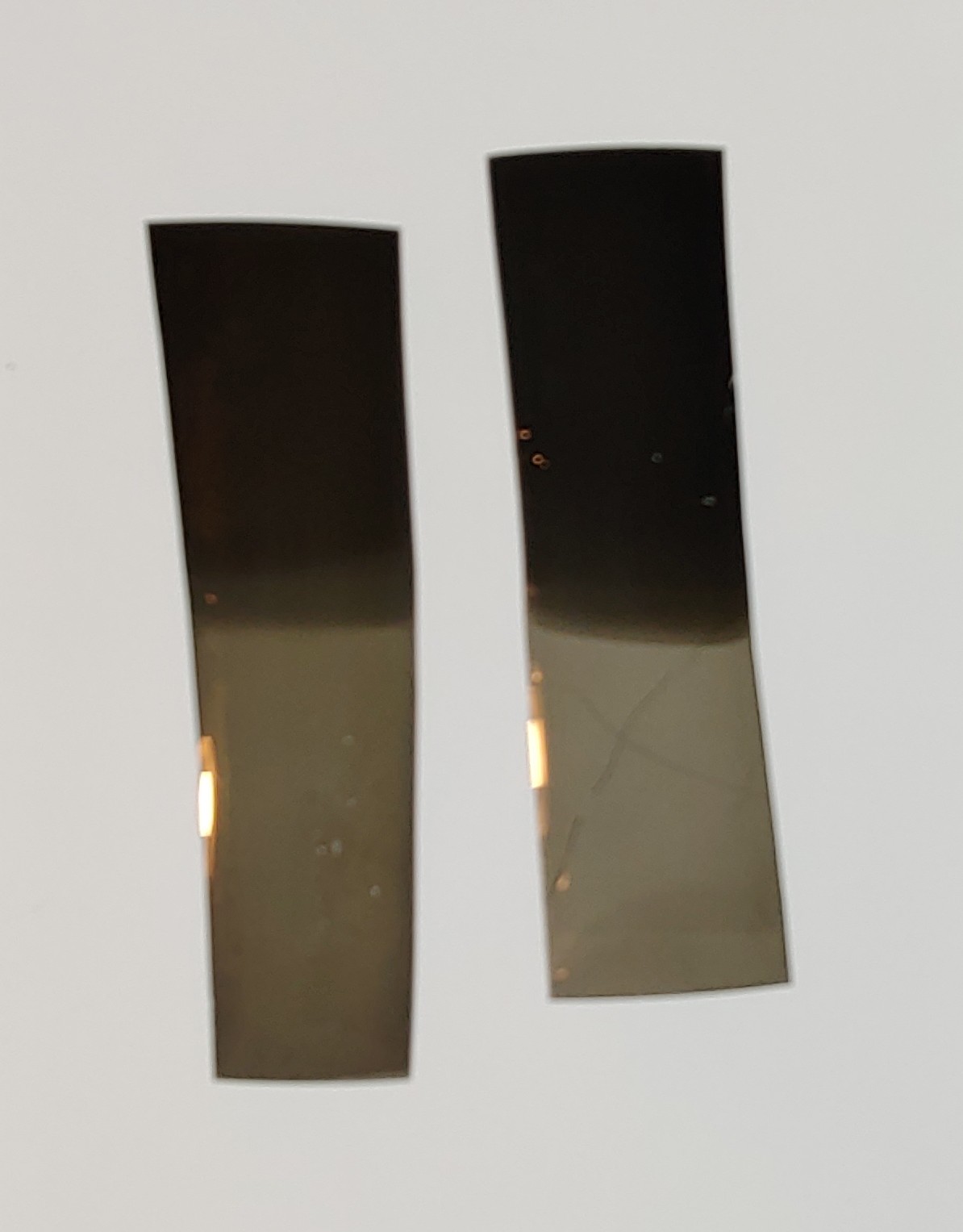

I performed a quick and dirty test. Given what I could get out of the old bottle, I set up 2 small plastic graduates with 2+100. Left is "fresh" out of the glass bottle, right, the cough syrup dark HC-110 that has by now been in the mostly empty bottle since Tues, 2/16 (6 days).
I eyeballed it a bit. I held the test strip more or less half way in the developer and slowly swished it about until it was clearly darkening - in this case, 3 minutes. Then I dunked the whole strip for another 3 giving a 3/6 minute strip. Not particularly scientific, but it's something. After the time was up, a quick rinse in tap water, then into fixer.
Both strips were photoed on my light tablet/table with my cell phone camera in manual mode (LG V40).
The left strip done in the clear developer did noticeably darken a bit more, but the deep red "sludge" was clearly still quite active.
