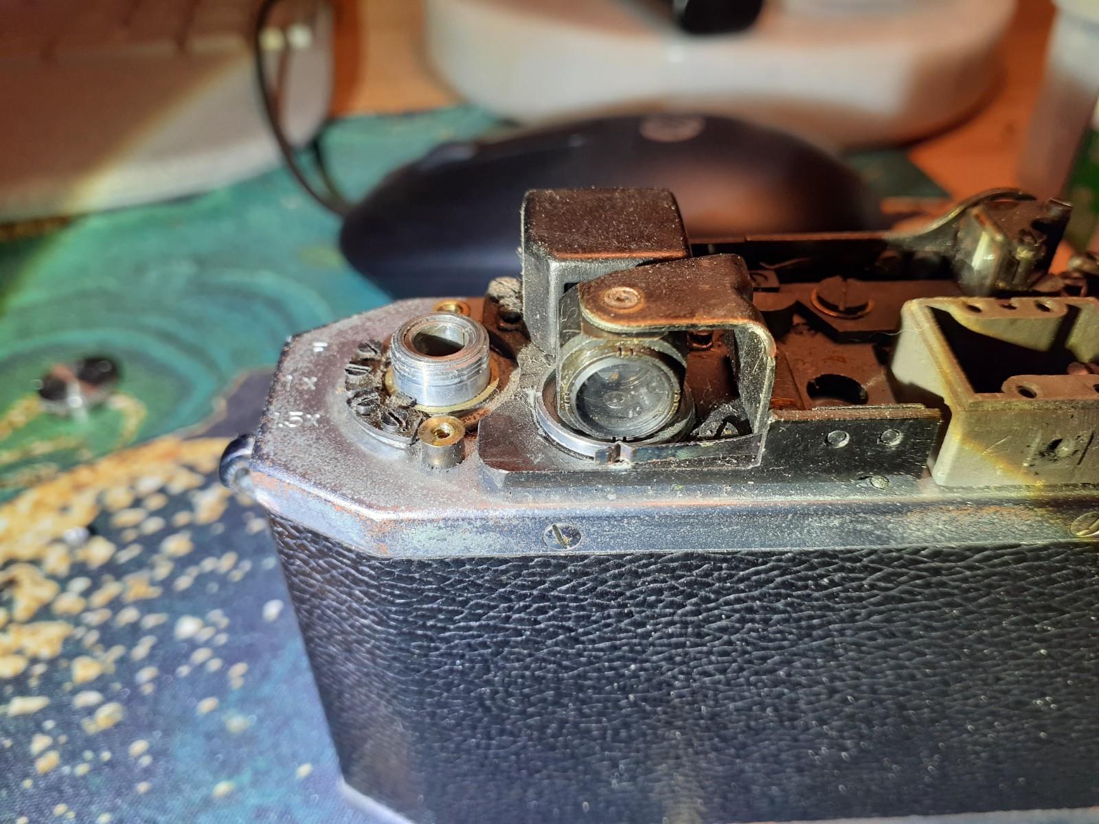

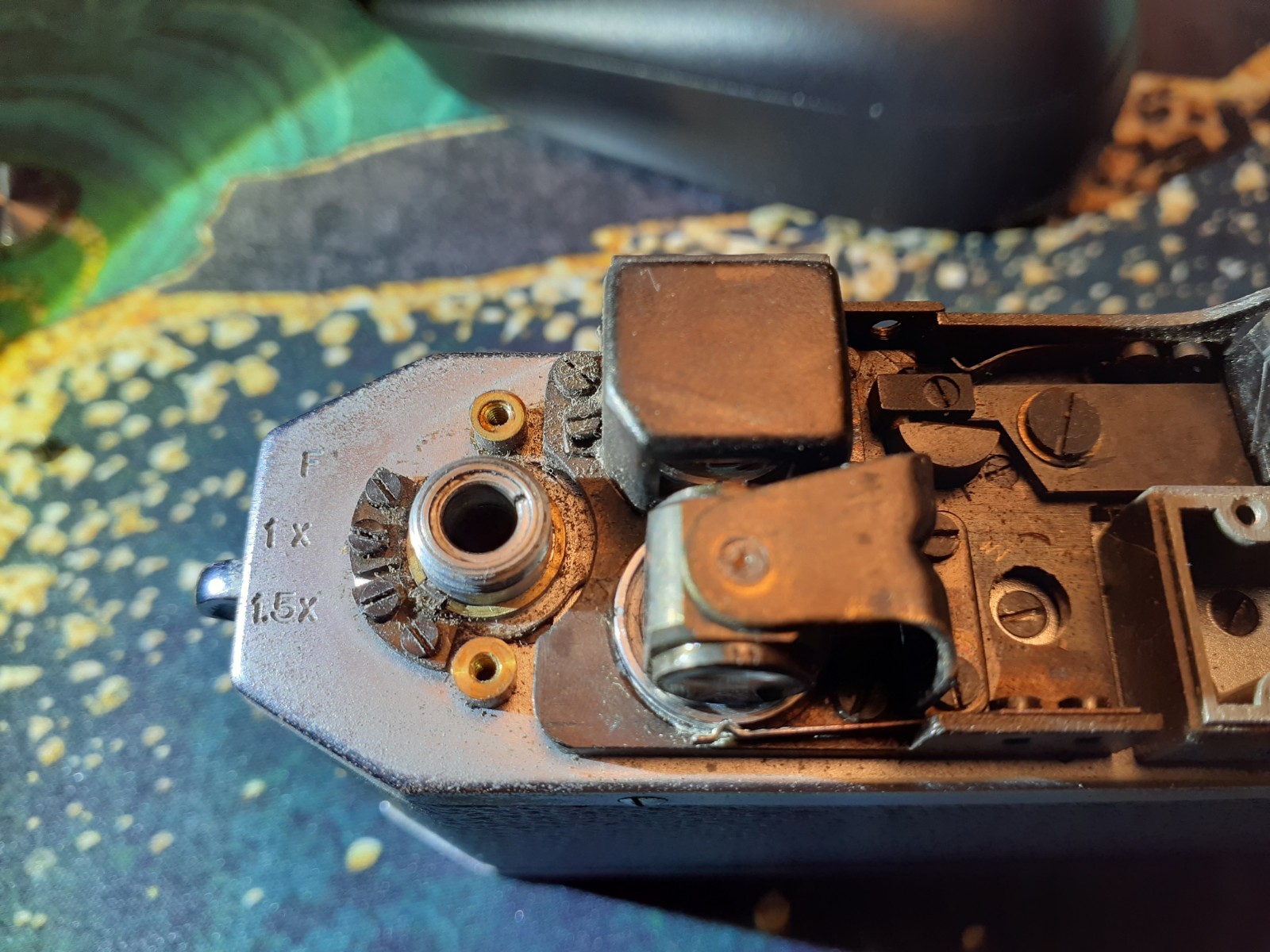

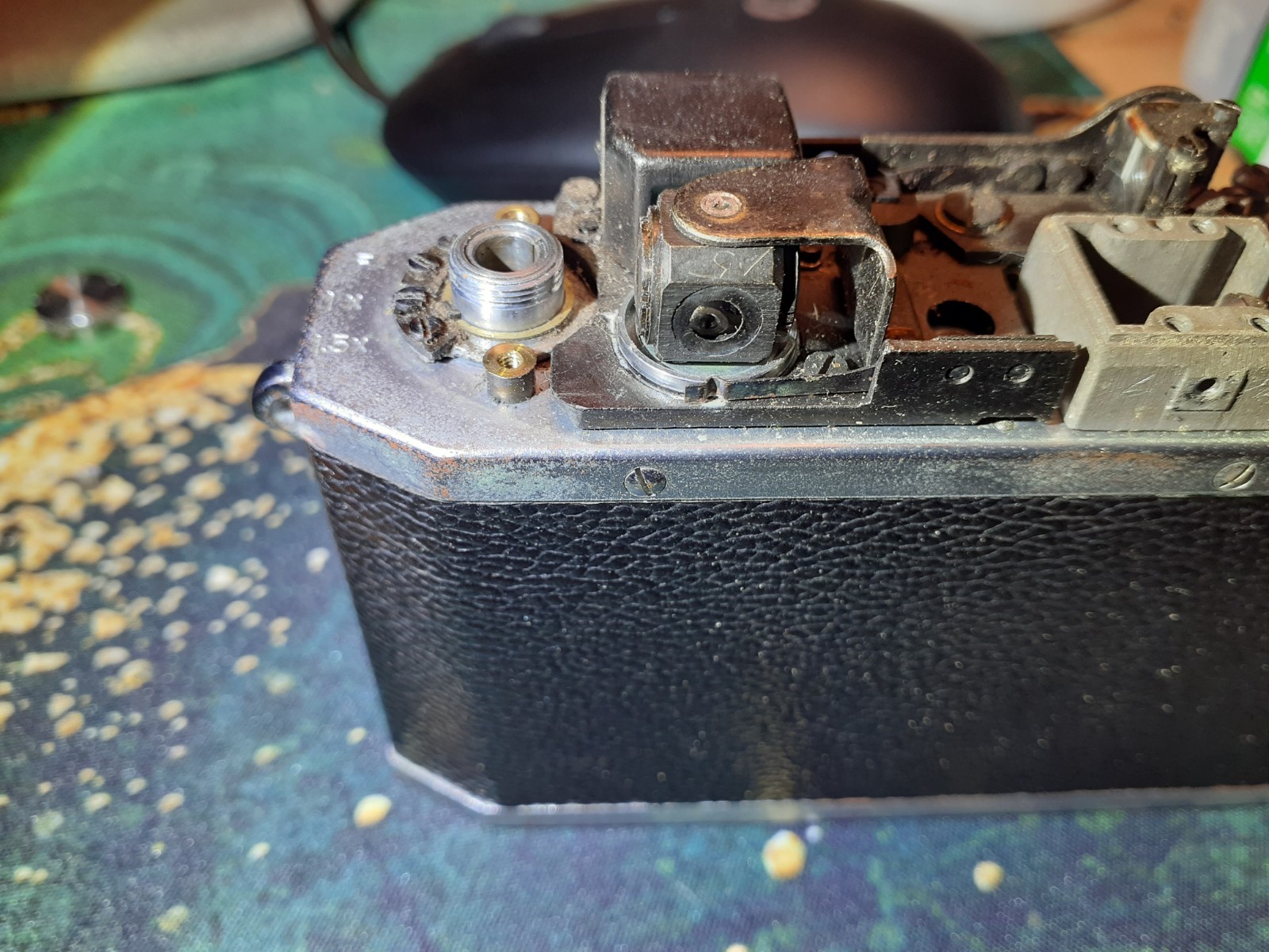

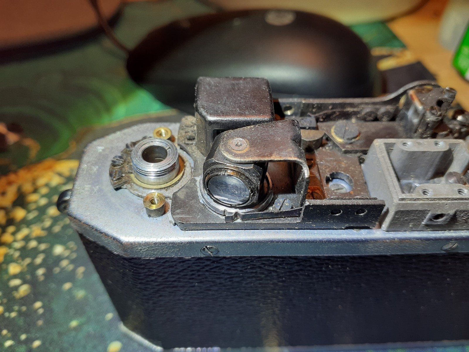

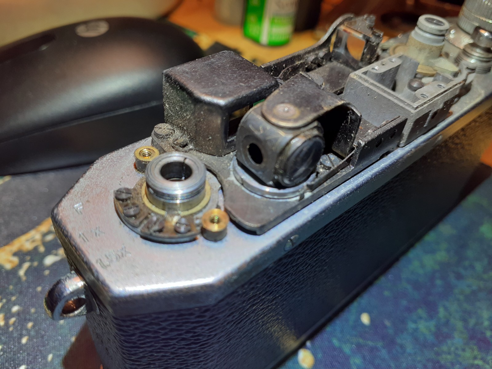

@reddesert I was incorrect - it is a rotating lens and mask assembly, not prism. There are 2 lenses and masks on the rotating cube shown. This particular camera - that is waiting for me to repair it - actually needs to have the rotation adjusted because it doesn't fully lock into the detent of the F(ull or 50mm) view like it should (first photo). The small circular mask is the 1x (90/100mm) and the lenses and mask are reversed from the F setting to give the 1.5x (135mm) view.
You can see in the first 3 photos the rangefinder prism to the right at the front of the top plate.

Thanks for these pictures! This is the arrangement that Rick Oleson diagrammed in his writeup I linked above, where the (variable magnification) eyepiece optics are entirely behind the rangefinder part. My guess is that for later RFs with larger viewfinders, eyepieces, and higher eye relief, that an arrangement like this would get quite large, and maybe that's why subsequent cameras don't use it.
Also, people may have felt that projected framelines gave greater framing accuracy, I don't know but I thought that was one of the selling points when RFs with framelines became available.
