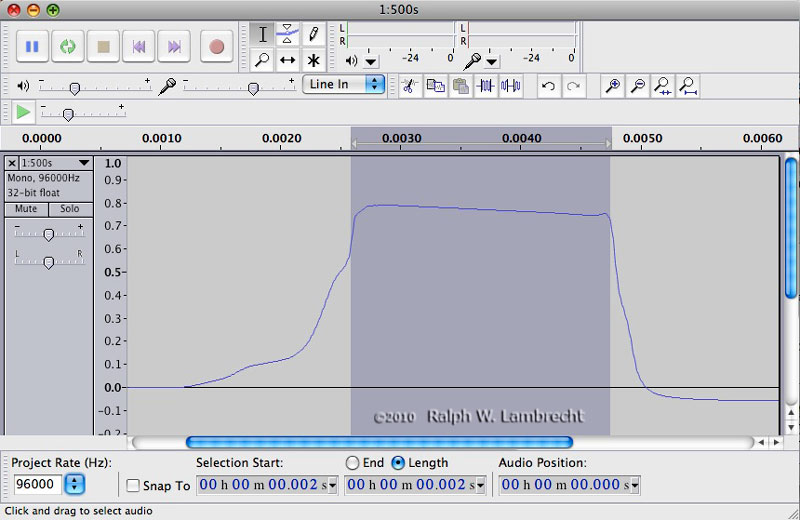

Krzys
That's a great method, and I have used it many times. I also have a Calumet Shutter Tester, which is unfortunately not available anymore, and used right, the audacity method in combination with the right detection hardware is more accurate, because it can records more cycles per second. Attached is a test of the 1/500s setting on a Nikon.

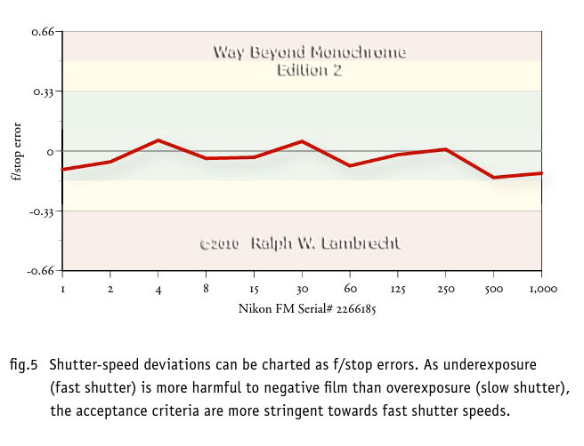

When you,'ve tested your shutter speeds and assumint your test is accurate how do you know what margin of error is acceptable and still be within tolerance ?, because no shutter is absolutely accurate,.
This depends on what materials you use it for (B&W, slide, color) and what you are willing to accept, but there is a standard for shutter speeds and it is rather liberal.
I use the following for B&W materials:
