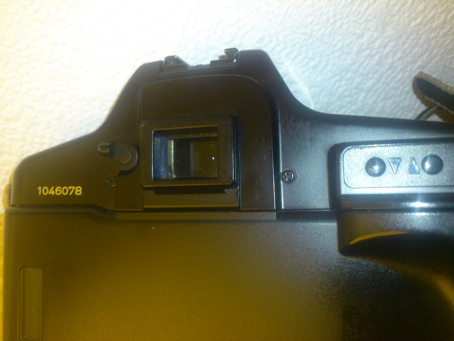

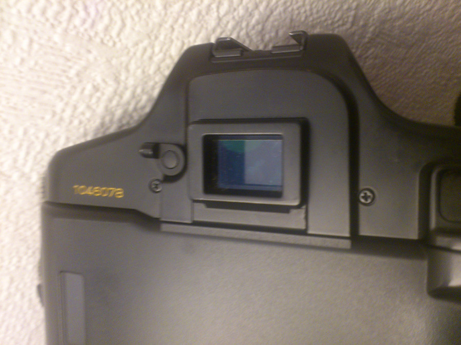

here is the photo of my T90 eyecup. Can you compare it?
Regards,
AgX
Apr 5, 2007
29,973
Germany
Darko, that is no eye cup.
Just the plain accessory frame of the diopter.
