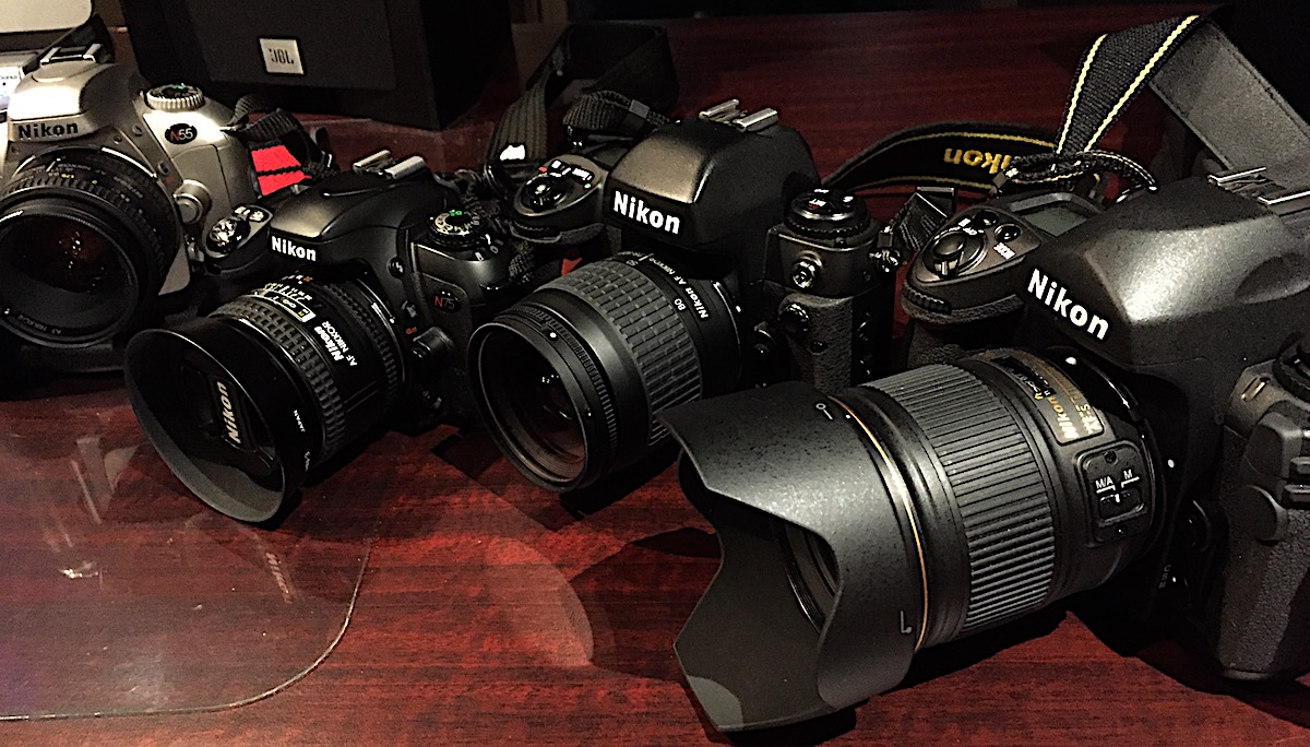

I got into the Nikon system about 7 years ago just because of the AF. Not regretting it one bit!
