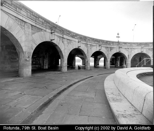

The 120mm Perigraphe is a fun lens. I should use it more often. I had mine mounted in an Ilex 3 shutter, and it just covers 8x10 when stopped down to about f:32 or so. I've mounted a 3" filter holder behind the lensboard, because anything in front of the lens reduces coverage.
You might find composition on the groundglass a bit of a speculative exercise, but a Silvestri tilting loupe helps, and be sure to let your eyes get used to the dark under the darkcloth.
Here's an old sample image I've posted before:
