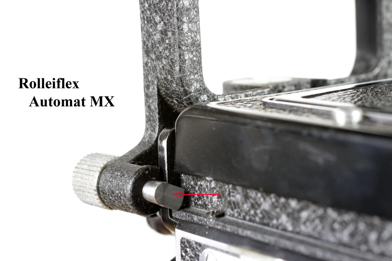

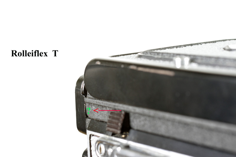

I am sorry, but I'd like to understand how a Rolleimeter 3,5 fits a Rolleiflex T...
On later Automat's (and E), there is a hollow on each side of the name plate where fasteners of Rolleimeter can be engaged.
There is not on T.
And on earlier Automat's and Cord's, the nameplate is too thin.
So, I don't know how to adapt this Rolleimeter on T and Cord's...
There is not on T.
is View attachment 183440 View attachment 183441
Andy, thank you for your descriptive explication !
Indeed, I suspect you are right. Now, it'a riddle to me, why so many maintain the reverse.
