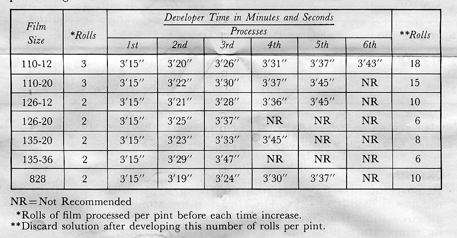

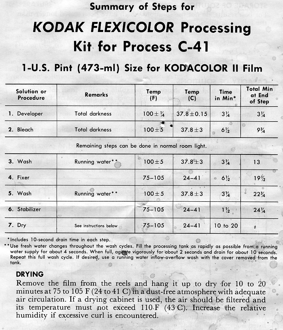

Non RA Kodak C41 process - repost
For everyone here, I am reposting the Kodak C41 instructions along with capacity of the developer.
PE
