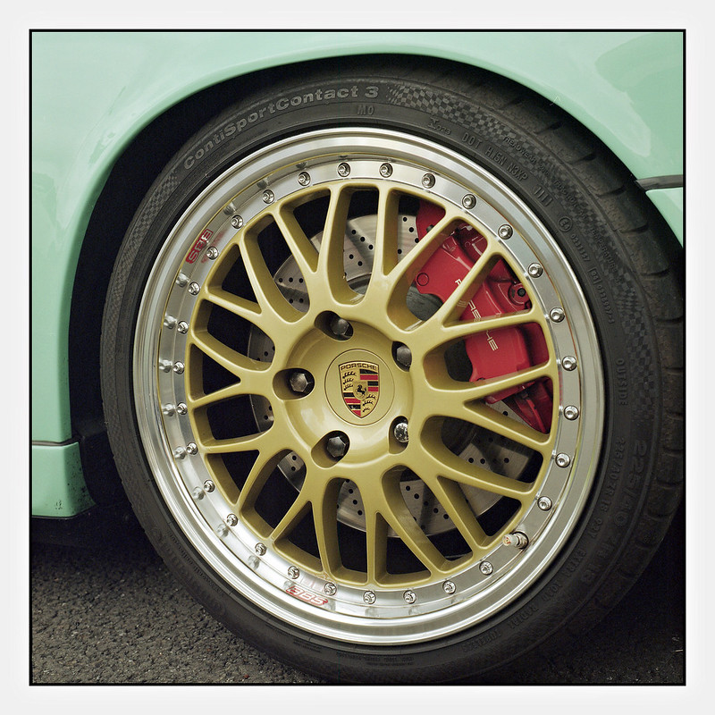

And finally, just some interesting comparison shots, I took some pictures of a car's wheel with a few caneras. Apples and oranges again but at least it's a real data point. I believe the Rolleicord is focused a bit farther back than the other two. And color ruins the picture. But anyways:
Rolleicord: https://www.flickr.com/photos/132764966@N03/48477766917/in/dateposted-public/
Rolleiflex: https://www.flickr.com/photos/132764966@N03/48477805692/in/dateposted-public/
Hasselblad 60mm Distagon Black T*: https://www.flickr.com/photos/132764966@N03/48477631616/in/dateposted-public/
The hasselblad is obviously the best. But if I had never showed it to you I think the Rolleicord makes a very good picture.
