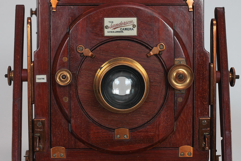

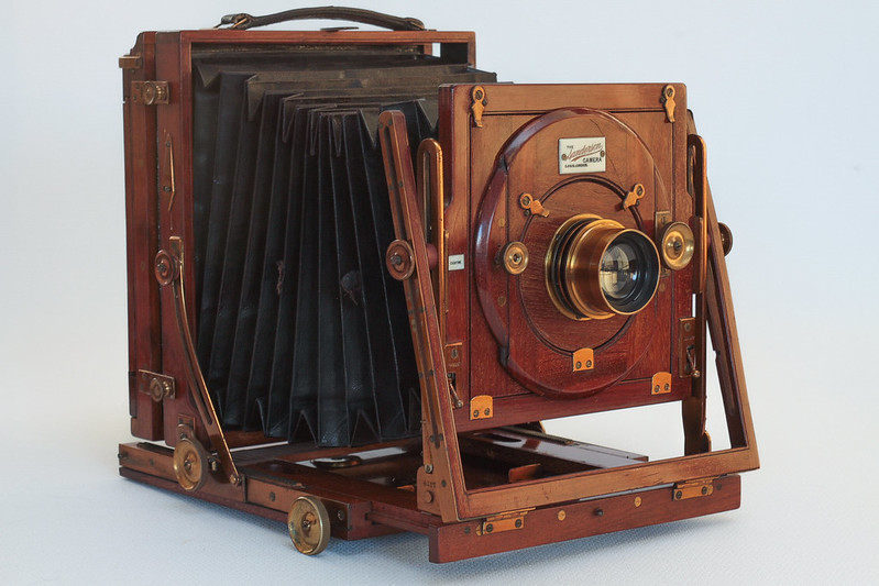

Last week (dec 20/jan 21) found some time to put pics on the net of my A-pattern (for more info about camera and lens, click picture):
Sanderson A-pattern half plate camera (1)
by Ron (Netherlands), on Flickr
Sanderson A-pattern half plate camera (2)

I'm wondering if it means the front standard design-- it almost looks like the front standard is designed for the struts to not be vertical. Perhaps the idea is by angling the struts to each other and the standard, you get a more stable base (and an "A" pattern).
Or perhaps it's because they're for Architectural work.

:smile: thanks all for having a look into this thread. From what I've read the Sanderson camera with the - what they called - compound front panel and the combo of wooden and metal struts, was presented at the world fair in London. They presented 3 types, called A-Pattern, B-Pattern and C-Pattern. However investigation revealed that there could have been only an A- and B-pattern camera, since there were only 2 presented at the fair (btw I've lost track of the source but if I can find it I'll post it here).
I guess 'pattern' was in those days a chique word for type. They were made in almost all in its day common camera dimensions: from quarter plate to the huge 15x12 inch.
The camera was indeed developed with in mind architectural photography, although I've never found any info on how Sanderson actually would make use of the compound front in combination with the different struts.
Btw the compound front makes it possible not only to shift the lens in horizontal and vertical direction, but in very direction in between. The combined struts provide lots of variations of tilt (further the back panel has the possibility of tilt and swing).

But if you use the oblique strut from the rear standard the same way at the front, and that is seemingly done here:
http://www.earlyphotography.co.uk/Images/C305.JPG
and with the front panel sliding in the vertical struts, the wooden U-shaped, hinged frame yields no benefit.
That is what I am wondering all about so far.
This is what I found on the - what Sanderson called - the Universal Swing Front:
"The second aim of the Universal Swing Front was to allow the camera baseboard and therefore the tripod to remain level and do away with the necessity of tilting the camera and tilting the back. When taking subjects such as buildings a problem would be the amount of foreground shown on the screen, to overcome this the photographer would tilt the camera up, this will introduce converging verticals which was remedied by tilting the back so that it was vertical. In Sanderson's design the camera bed is kept level and the lens is raised, for which there is ample rising front available, and tilted as required. A test took place in Cambridge in 1897, the results were widely reported in the photographic press and substantiate Sanderson"
Apparently until then camera's were mainly equipped with only tilt of the back panel.
"Sanderson’s patent of 1895: This describes how the lens board is held between two pairs of slotted struts, a screwed bolt, connected to the lens board, passes between the slots to clamp the lens board to the struts. When unclamped the lens board is free to move vertically, tilt and move forward or backwards. This allowed the photographer to roughly focus and compose the subject, then with the struts unclamped a single movement would move the lens board to critical focus and bring the rising front into play. On later models there would be pre-set catches to set the front standard in a vertical position."
The first camera introduced, had metal struts - the wooden only later added to provide more stability.
