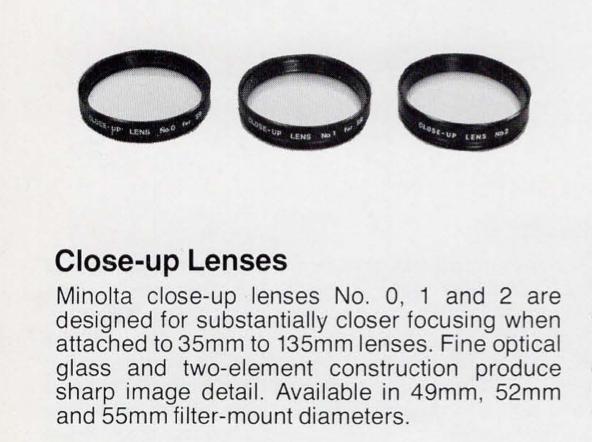

That Minolta No. 0 lens is for it's 16mm II camera. I'm referring to the Minolta No. 0 for their 35mm SLR cameras that were made in 49mmm, 52mm, and 55mm thread sizes. Unlike the distance lens for the 16mm camera, the 35mm No.0 was a close-up lens with a diopter of #0.94 -- a focal length of 1,063.8mm, and designed for longer than normal lenses.
Ok I see them now.

Topcon also had a "0" for the 100 and 135mm telephoto lenses. Maybe, like the Minolta, a fraction of one.
