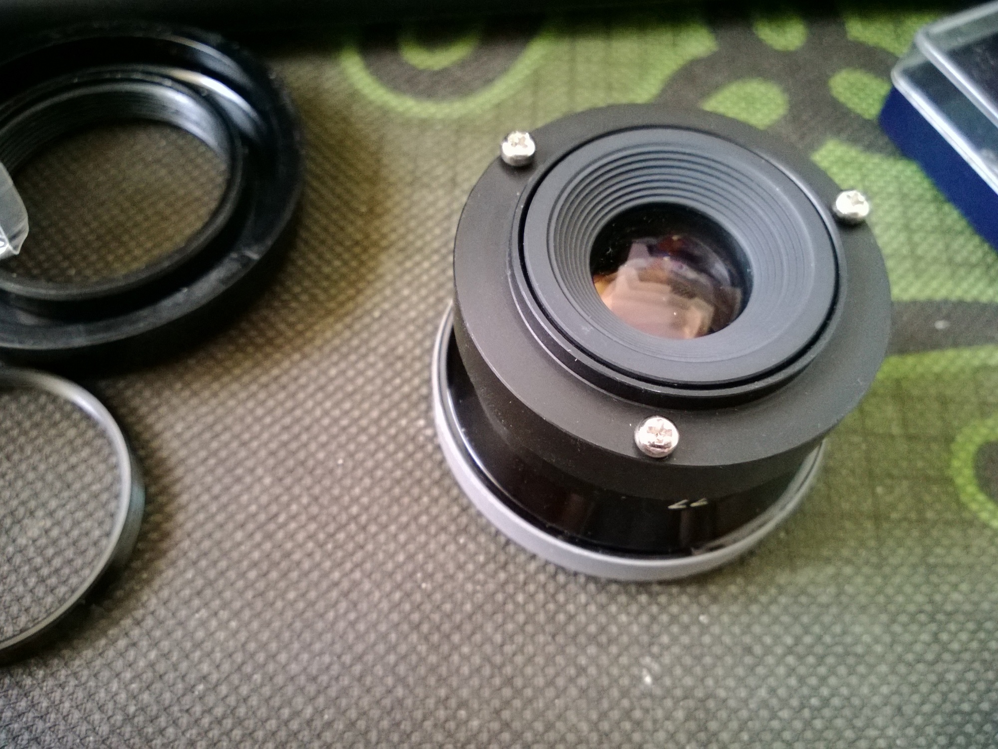

Kyon Thinh
Sep 22, 2012
91
People,
I got a Fujinon EP 75mm for my enlarger, but I can't remove whatever behind my lens. I have tried removed the 3 screws but it is still impossible to remove the thing. Do you guys have any idea?
