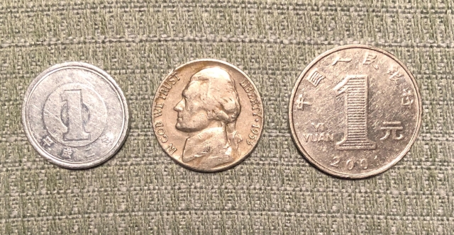

For many years I've used Japanese 1-yen coins on the battery compartment caps of my mixed collection of cameras and light meters. It's slightly smaller than a US nickel and is made of aluminum so it won't mar the slot. However, both the nickel and the 1-yen coin are small and it's hard to generate much torque. Maybe that's a good thing, maybe not.
Today I stumbled onto a new tool - a Chinese 1-yuan coin. It's slightly thicker than the 1-yen coin and is actually a better fit to every cap I tried (over half a dozen cameras and light meters from Nikon, Olympus, Voigtlander, Mamiya, Pentax, Zeiss, and Gossen). Aside from the improved fit, it's a bit easier for me to handle.
The downside is that the 1-yuan coin is steel (or some magnetic alloy), so it'll damage the slot if you're not careful and it slips. But it's a good fit, and its increased size reduces the chance of that happening.
Left to right: Japanese 1-yen coin, US nickel, Chinese 1-yuan coin.

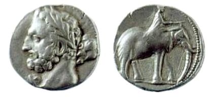

That Carthaginian shekel is lovely, but I'd only use it on my Leica (if I had one).

Bah ! Made in China ? Here's the Leica version ...
A Carthaginian shekel, dated 237-227 BC
Last evening I was watching the first season of sci-fi show “The Expanse” where I heard a character refer to the space ship “The Scipio Africanus.” That rang a bell, in part because I’ve live in both Algeria and Tunisia, so off to Wikipedia, where I re-learned that Scipio had defeated Hannibal near Carthage o/a 202 BC. And had defeated Hannibal’s brothers in Carthaginian Iberia. Cool that you have a coin from all those centuries ago; I’m sure Hannibal et al would be pleased to know they are remembered
