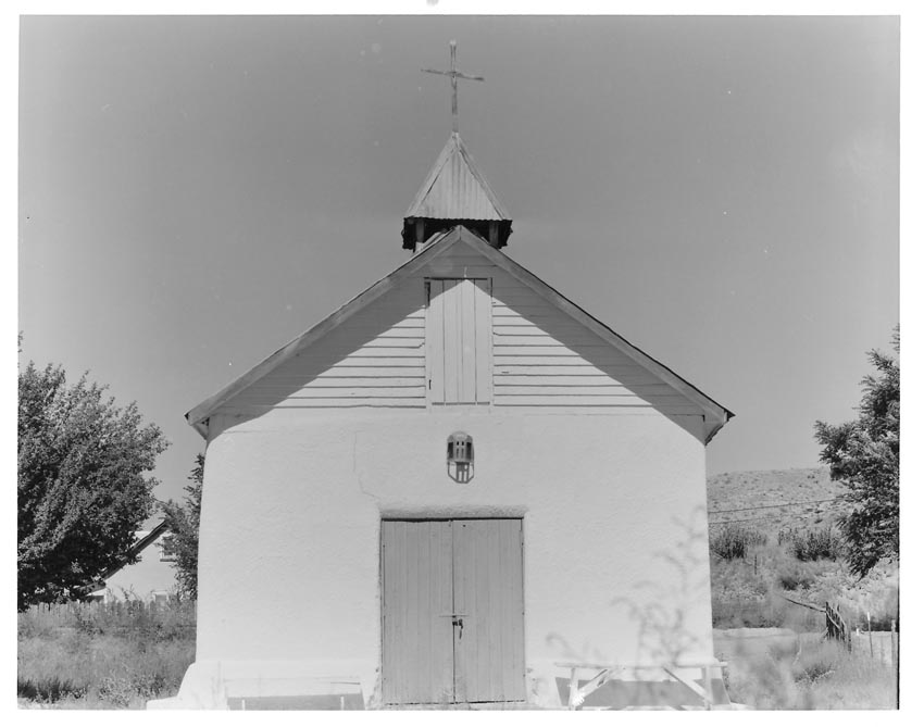

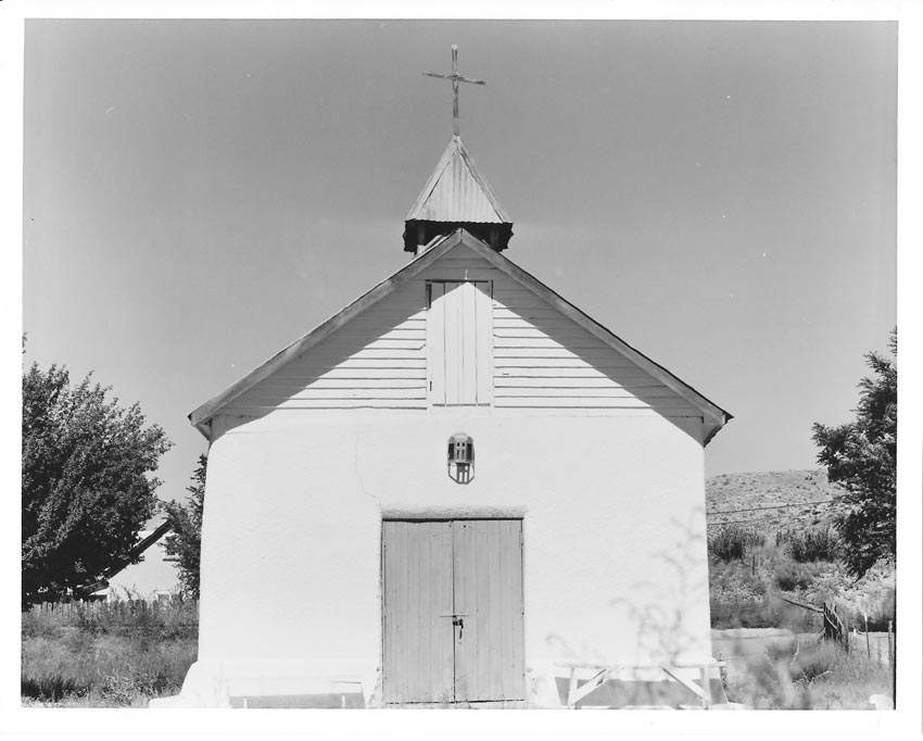

Here you go Robert.
One of the Oriental, one Ilford filtered to Grade 4, same neg.
The third print is on the Oriental and with a little more work it ought to be ready for a final print. It's a straight print and with a taste of dodge/burn it should be done.
The only manipulation I did here was to set the white point with the dropper on the border of each.

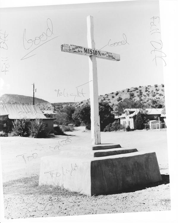

Definite gain in contrast. Wasn't that a cool little church? I wish we could have helped them out on their power bill.

I see the big difference, thanks for posting the pictures. Hmm...is the Ilford paper fresh? Did you try the Ilford paper at Grade 5 also?
Having used Ilford MGIV RC paper extensively, plus quite a few graded papers from all sorts of manufacturers. I would be hesitant to suggest the difference is normally that startling.
I have the impression that the Ilford paper (as presented) doesn't look anywhere near the same contrast as the graded paper. Looking at the shadow detail in the foliage, I would assume the Ilford paper has actually been exposed at a far lower contrast than a true grade 4 on the multigrade scale. The Ilford paper looks muddy and soft and slightly over exposed.
It is possible for a number of reasons that this may be the case, safe lights, light source, filtration system, paper age.
In the past I have switched to a graded paper for a slight lift in certain aspects from a negative. A graded paper will certainly produce different results, and I have certainly produced far closer (not identical) results than what I'm seeing, in all situations.
Interesting presentation nonetheless, thanks for showing.
Mick.
Mick,
I don't know the age of this box so that is a distinct possibility. In previous sessions though this box has printed the same as fresh.
The filtration is right, two filter (M&Y) setup as specified by Ilford. Saunders LPL with a color head.
Safe light is about 6 feet away and sits on top of a shelf that blocks any direct to-the-paper lighting. Has to bounce off the ceiling first.
The sheets move from the paper safe to the easel and are being exposed within 5-10 seconds, after exposure the go into a JOBO drum, about 10-15 seconds there. Total exposure to the safelight on a sheet where I'm all thumbs is still under 45 seconds.
Did not try 5.
I printed another XP2 shot that is not shown and the Grade 5 filtered Ilford MGIV is very close to RA-4 and this Oriental Grade 4 paper.

If you constantly have to use grade 4 (or higher) paper then your negatives are underdeveloped. Increasing development time will improve shadow detail in the negatives. I would suggest reading Ansel Adams "The Negative" and also "The Print" for more information on adjusting the film characteristic curve to that of the paper.

I have been using Ilford MGIV for many years with several films from 35 mm to LF. I was surprised at the "muddiness" of the prints posted above because it did not agree with my experience. My first thought was that this negative is underdeveloped. The negative looks properly exposed because I see detail in the shadow. If the negative was properly developed a grade 4 would make that branch shadow on the wall look "unreal". Increasing development time will also balance the overall contrast of the negative.

The negative is as stated above is FP4 in Pyro. It had plenty of exposure and was developed at a workshop under the tutelage of Per Volquartz.
That's actually not a shadow on the wall, it's a weed in the foreground.
I do fully realize that I can increase development to "balance" the negative.
The question though is "balance to what?"
Grade 2 is simply the traditional choice.

Well given that the XP2 shots are printing nicely on the Oriental paper too, the FP4 is probably lower contrast than is traditional. For all I know that may be a Pyro thing.
This is not necessarily a bad thing in my mind, lower contrast adds flexibility at the camera and minimizes grain.
