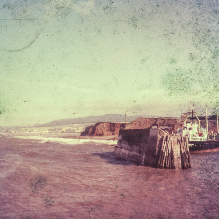

A dozen or so boxes of mounted 35mm colour slides has recently come into my possession - so, perhaps 300-400 individual slides.
These are my family's holiday and special occasion snaps, some on Kodachrome, some on a variety of "Boots", Ferrania/3M and other brands.
They date between the mid-1960s and perhaps late 1970s, and had (unfortunately) been stored for the past few years in a polyethylene bag in an outdoor concrete shed.
My intention was to scan them and distribute electronic versions to the remaining members of the family.
Opening one or two of the boxes, some seem to be fine, whilst others seem to have suffered deterioration.
An example is linked below. If I saw this on a lens, I'd assume it was fungus.
I am rather disinclined to put these through my scanner as I don't particularly want to distribute spores about the place (assuming this is fungus), and especially don't want spores transferred to any of my current B&W negatives which might also go through the same scanner.
Am I worrying unnecessarily?
Is there an easy way to cleanse/disinfect the damaged slides? (I mean by me - they are almost certainly not worth having professionally restored, even if that is the only way forward)
thanks for any advice

If the fungus has eaten into the emulsion, damage has occured and cannot be reversed. I have used PEC-12 cleaner and PEC Wipes to clean slides, and it does take the fungus off. It will at least improve things, and is worth a try.

I'll probably get out the isopropyl alcohol and cotton buds, as I have them to hand, and PEC12 is a useful suggestion.
I'm still interested to know whether these slides are a "danger" to my recent negative materials which might share a scanner?
(I realise that good storage is the key, as the air is laden with spores anyway so all material already has the potential to grow visible fungus, but better safe than sorry I suppose)
EDIT
Aha! I just found an APUG post by no less than PE, who notes that the remaining silver in B&W negatives acts as an effective deterrent to fungal growth; in the same thread he and others note the use of formalin to kill fungus, and that's pretty easily available (though nasty stuff)..
So I reckon I could clean off the slides as best as I can with either IPA or formalin, and then not worry too much about "infection"
