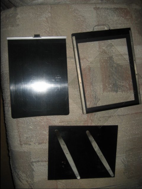

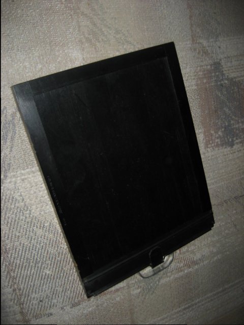

keep your eyes out for a "pressure plate" style holder. they were designed to hold film very flat. i use it for shooting glass and aluminum plates. i have a 5x7 and an 8x10. they slide into a regular spring back. they look very very similar to a regular film holder. no modifications or new camera needed!
