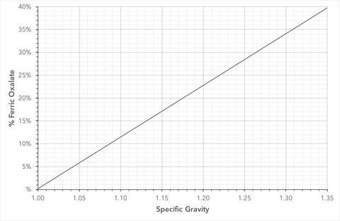

I found another table online that corresponds to the specific gravity and content of iron oxalate. It's different from yours. Which one is correct? thank you.
They're both correct, but measure different things. If you base your %wbv calculation on the commercially available dry powder, then you aim for about a 27% solution. If you base it on the actual iron(iii) oxalate content then you aim for about a 20% solution. The bottom line is to aim for a specific gravity of about 1.18 and then be consistent.
