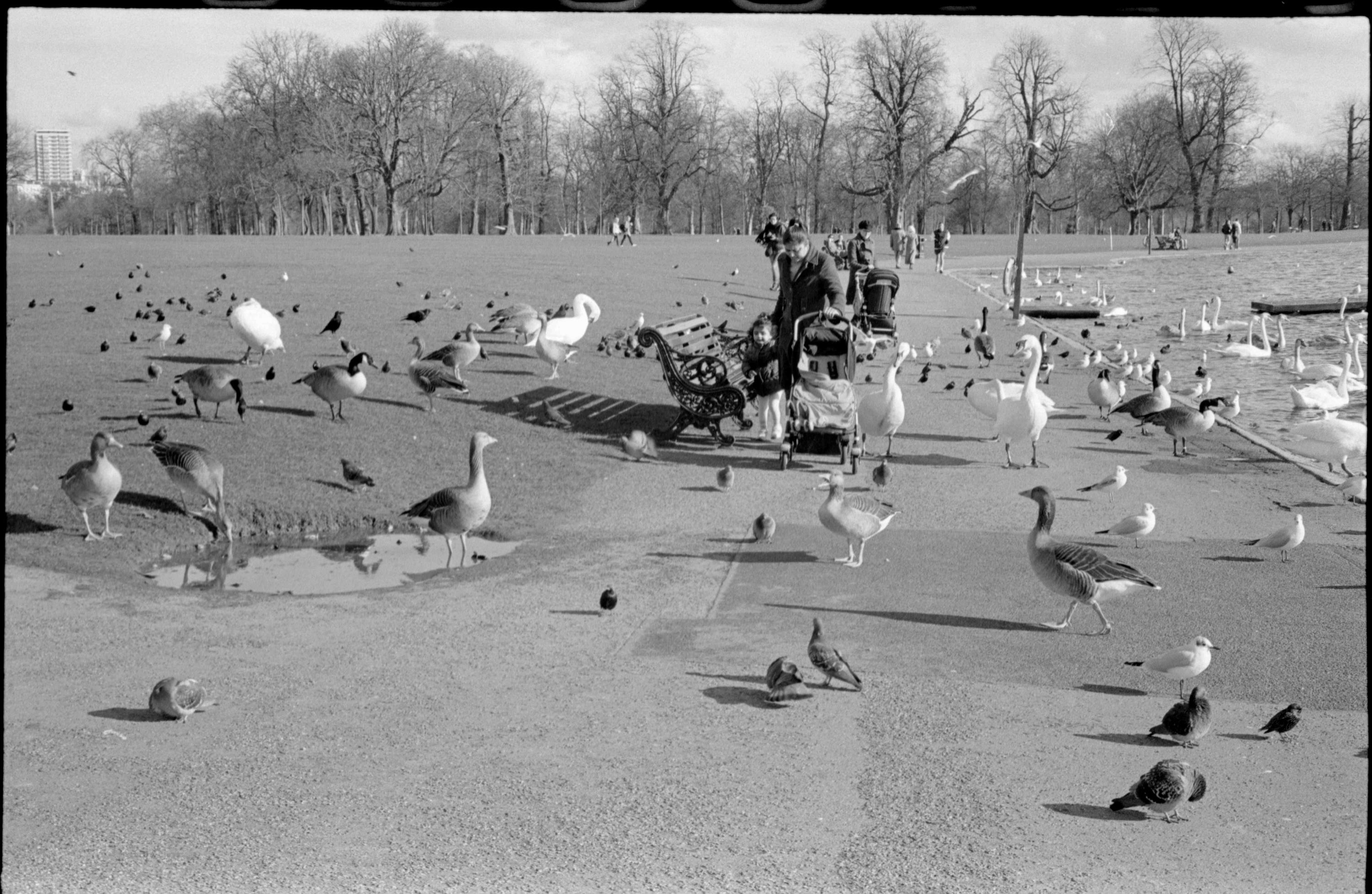

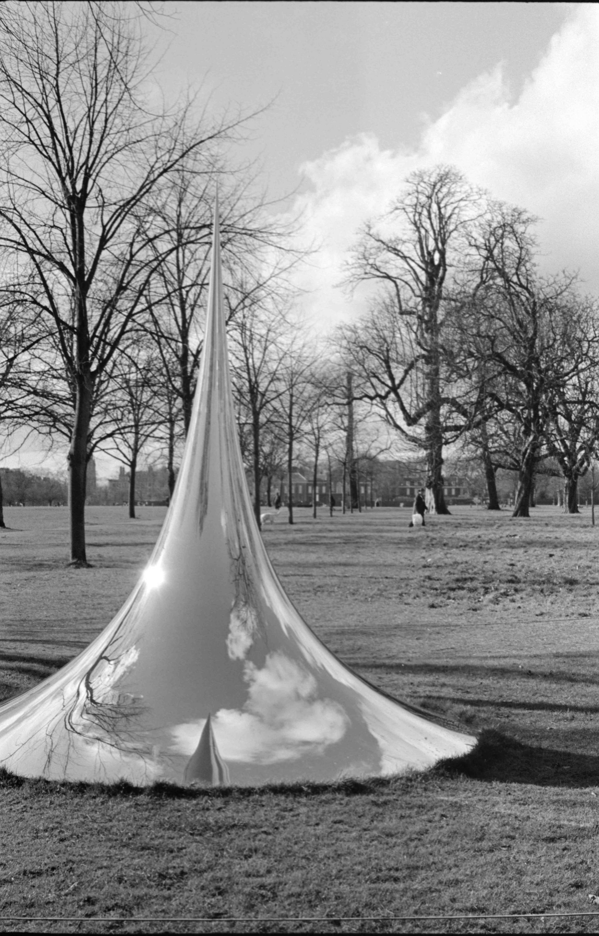

Like some others, I've worked backwards in a way and have come to analog from digital. It's been quite a lot of fun, but I'm having a bit of a problem dialing in my Tri-X development time. I shot a few test rolls, and tried times in XTOL 1:1 ranging from 8:30 to 9:30 (all at 20C), wherein I agitated from the pour (into a two reel Kaiser tank) until the first 30 second mark, and then performed three inversions (taking roughly 5 seconds) at every 30 second mark thereafter. The 9:00 time (I begin pouring the developer out at 9:00) looked the best to me as I still had details in my highlights and in my shadows.
Enter the frustration: I shot a couple of rolls yesterday, and followed my tested time. I scanned the results (with an Epson V700, and don't even get me started on its focus issues) and found myself a bit stumped as to whether I was looking at underdeveloped negs or underexposed ones. I know it's an issue that's arisen before, just as I know I did underexpose a couple of frames by about 1/2-2/3 stop. Still, the images look duller than I thought, and I'm not sure whether my issue is with my development time, my exposure, or my scanner.
So here are three examples, and I look forward to your collective analysis. Incidentally, for the sake of thoroughness, the remainder of my development process is a 30 second stop bath followed by 3:00 in Ilford Rapid Fixer, then a lot of washing and a final dip in photo flo. All images shot with a Leica M6 and at an EI of 400.
Thanks ever so for any insight.

To me the negs look OK. You have details in the shadows and the highlights looks OK at least the skies.
I can see that you have long shadows. Perhaps the light was becoming a bit flat and that is what you see in your scan.
It seems that it would be possible to get a decent print from this negative.

I think your negatives look fine, with both whites and blacks. They certainly don't look underexposed. And I personally like the detail in the shadows. My X-tol 1:1 time with Tri-X at 20 degrees C is 9 minutes, with similar agitation. A little extra time would perhaps give you a bit more sparkle in the whites, if that's what you are seeking.
It kind of looks like London, which can have flatter light. Perhaps run a roll of HP5+ or even T-Max or Delta 400. I find those can be more contrasty in X-Tol. One of the neat things about film is that each type will give you a different look.

Negatives look fine to me. I can see scene 1 was an extremely bright scene and on scene 2, you had a back lit condition evident by some flare at the top. When you print this, you will see higher contrast as there is no way paper can express this much dynamic range. In scenes like this, I don't think under-exposing by a stop or so makes any difference since there isn't that much shadow detail to show anyhow.
My suggestion is to print them (with your choice of media) and then worry about contrast.

Your negs are fine. Use curves in Photoshop or Gimp to set your white point, black point and adjust the curve. I usually click in the middle to hold the middle tones and then click on the left and pull down to deepen shadows and increase contrast.
Thanks for the feedback everyone. Curves adjustments definitely improve the images, but they can only do so much given the dynamic range conundrum. There comes a point when the contrast overwhelms the frame and makes the image look too artificial for my tastes. I'll check out what Sandy King has said on the matter, and maybe the best thing to do is just use my scanner to give myself an approximation of what the pictures I made look like, then hire a more powerful machine for a couple of hours to scan the greatest hits. Gosh, everyone here's so nice...

The images you posted are super-high dynamic range, with ratios in excess of 128:1. If you were to open up the shadows beyond where they are now (a bit dark for my taste) you'd blow your highs into the stratosphere, and those highs I speak of would probably start somewhere mid-curve. For scanning purposes (and yes - I know this is taboo here, I'll be brief!) you'll need to drop development times to something like N-3 or even 4 (not really doable with Xtol) which would require a compensating developer, so you maintain texture in those tones and then apply your curves to pick up the highs to where you're satisfied with overall contrast. My suggestion is that you consider Diafine, which will get you in the general ballpark. Also, see Steven Schaub's many articles on Tri-X & Diafine on FigitalRevolution.com (now defunct, but the info is still there).

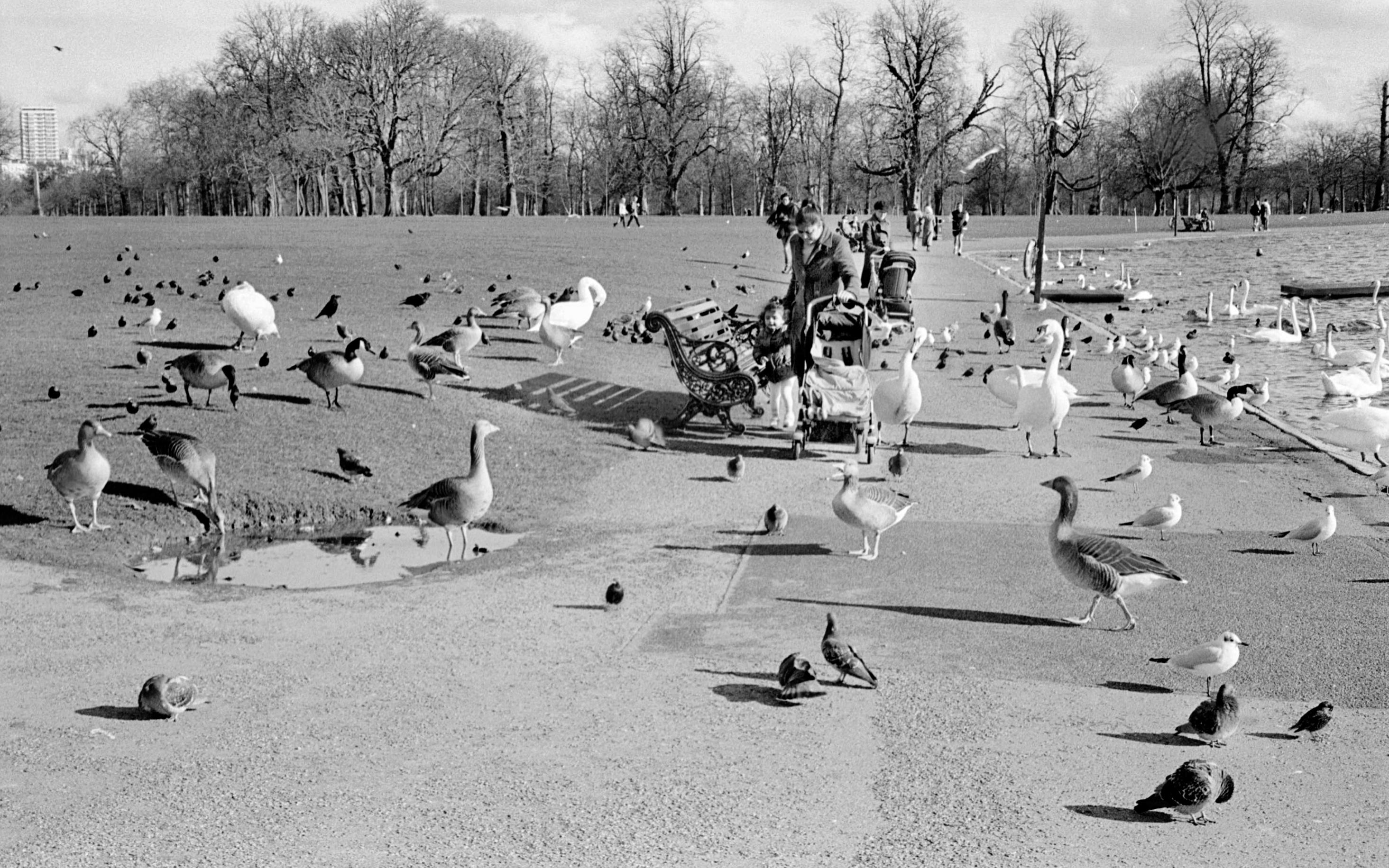

I took one of your shots and did a two second tweak by bringing the midtones down in the levels menu. You can clearly see that they're much too high in the originals. There is no problem with the scanning, it's your editing that needs a little work. Scanners are perfectly fine, you bunch of luddites! :tongue:
